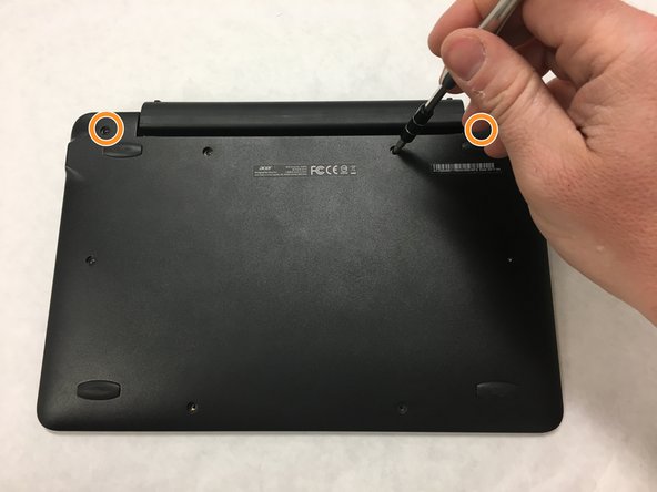

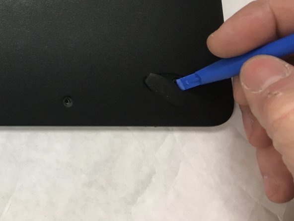

    • Turn over the keyboard and use the plastic pry tool to remove the two adhesive backed rubber pads furthest from the hinge.

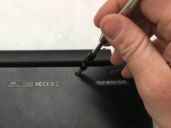

    • Remove ten total screws from the back cover with a Phillips #1 screwdriver.
    • 8 screws 4.25mm in length with 4.00mm diameter heads.
    • 2 screws 6.00mm in length with 4.00mm diameter heads.

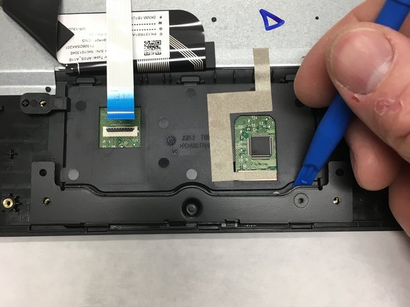

    • Use the plastic opening tool to separate the front and back halves of the keyboard.

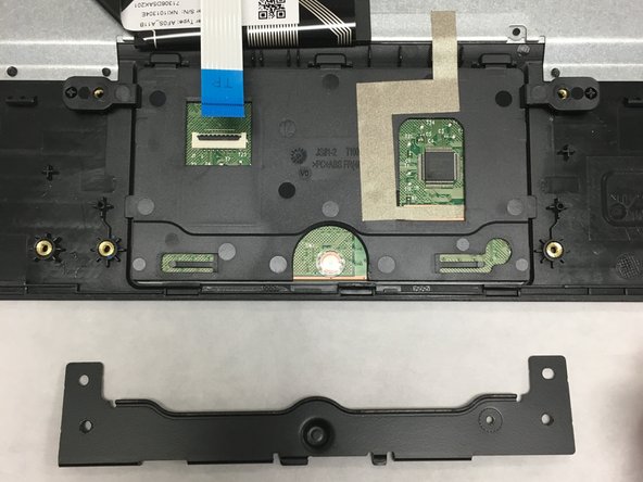

    • Use an opening tool to remove/peel off the adhesive tape from the trackpad electrical connector
  8. Acer One 10 S1003-114M Track Pad Replacement: crwdns2935265:08crwdnd2935265:01crwdnd2935265:02crwdne2935265:0 Acer One 10 S1003-114M Track Pad Replacement: crwdns2935265:08crwdnd2935265:02crwdnd2935265:02crwdne2935265:0

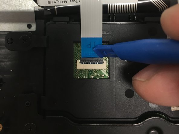

    • Use an opening tool to flip/pop the switch holding down the electric connector to the keyboard.
  9. Acer One 10 S1003-114M Track Pad Replacement: crwdns2935265:09crwdnd2935265:01crwdnd2935265:02crwdne2935265:0 Acer One 10 S1003-114M Track Pad Replacement: crwdns2935265:09crwdnd2935265:02crwdnd2935265:02crwdne2935265:0

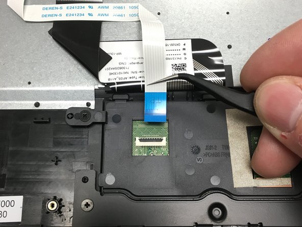

    • Use the fine tip tweezers to remove the electrical connector for the trackpad. Pull gently.
  10. Acer One 10 S1003-114M Track Pad Replacement: crwdns2935265:010crwdnd2935265:01crwdnd2935265:03crwdne2935265:0 Acer One 10 S1003-114M Track Pad Replacement: crwdns2935265:010crwdnd2935265:02crwdnd2935265:03crwdne2935265:0 Acer One 10 S1003-114M Track Pad Replacement: crwdns2935265:010crwdnd2935265:03crwdnd2935265:03crwdne2935265:0
    • To free the retainer, remove the 2 mount screws, 3.50mm length and 4.90mm diameter heads, with a Phillips #0 screwdriver.
  11. Acer One 10 S1003-114M Track Pad Replacement: crwdns2935265:011crwdnd2935265:01crwdnd2935265:01crwdne2935265:0
    • To free the trackpad, remove the 2 mount screws, 3.50mm length and 4.90mm diameter heads, with a Phillips #0 screwdriver.
  12. Acer One 10 S1003-114M Track Pad Replacement: crwdns2935265:012crwdnd2935265:01crwdnd2935265:01crwdne2935265:0
    • Use a pair of fine tip tweezers to remove the adhesive metallic strap holding the trackpad to the keyboard.
  13. Acer One 10 S1003-114M Track Pad Replacement: crwdns2935265:013crwdnd2935265:01crwdnd2935265:01crwdne2935265:0
    • Gently remove the trackpad from the keyboard.
