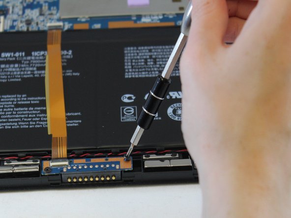

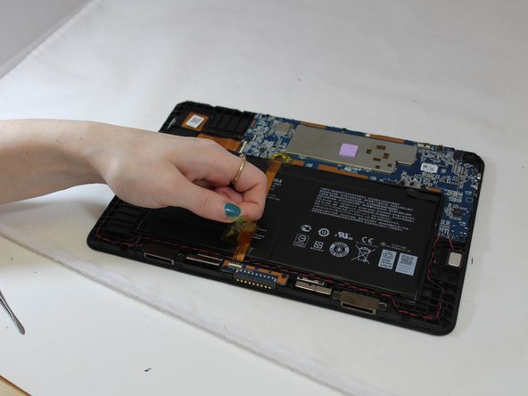

    • Using the Phillips #00 screwdriver, unscrew the two 2mm screws at the bottom of the tablet and open the ZIF latch.
    • Gently remove the gold ribbon cable covering the battery and set it aside.

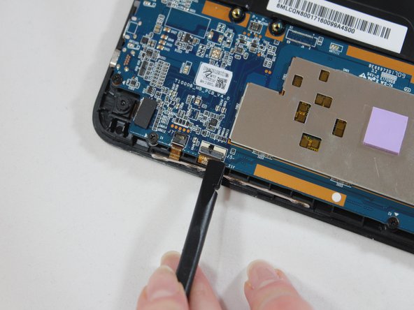

  9. Acer One 10 S1003-114M Rear Camera Replacement, Motherboard: crwdns2935265:09crwdnd2935265:01crwdnd2935265:03crwdne2935265:0 Acer One 10 S1003-114M Rear Camera Replacement, Motherboard: crwdns2935265:09crwdnd2935265:02crwdnd2935265:03crwdne2935265:0 Acer One 10 S1003-114M Rear Camera Replacement, Motherboard: crwdns2935265:09crwdnd2935265:03crwdnd2935265:03crwdne2935265:0

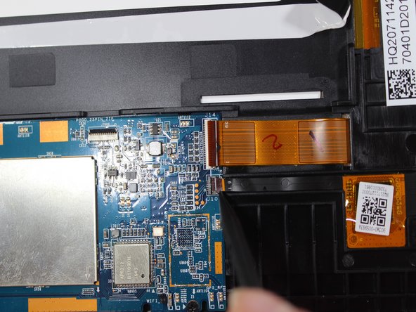

    • Using a spudger, disconnect the two ribbon cables on the top right and the three on the bottom left of the motherboard.

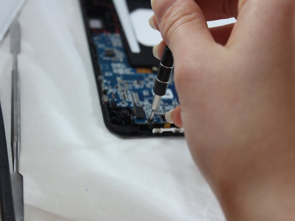

  10. Acer One 10 S1003-114M Rear Camera Replacement: crwdns2935265:010crwdnd2935265:01crwdnd2935265:02crwdne2935265:0 Acer One 10 S1003-114M Rear Camera Replacement: crwdns2935265:010crwdnd2935265:02crwdnd2935265:02crwdne2935265:0
    • Use a Phillips #00 screwdriver to remove the five 2mm screws from the motherboard. There are two on the left edge and three on the bottom edge of the motherboard.

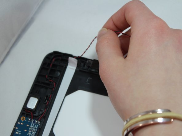

    • Using the spudger, pry the speaker from the right side of the tablet.
    • Lift the red and black wires attached to speaker on right side out of the track to where it connects to motherboard and the speaker on the left side.

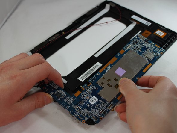

  12. Acer One 10 S1003-114M Rear Camera Replacement: crwdns2935265:012crwdnd2935265:01crwdnd2935265:03crwdne2935265:0 Acer One 10 S1003-114M Rear Camera Replacement: crwdns2935265:012crwdnd2935265:02crwdnd2935265:03crwdne2935265:0 Acer One 10 S1003-114M Rear Camera Replacement: crwdns2935265:012crwdnd2935265:03crwdnd2935265:03crwdne2935265:0
    • Use a spudger to create a gap between motherboard and back covering.
    • Using the spudger, gently pry the motherboard away from the back covering.
    • Gently lift and remove the motherboard and speakers from tablet.

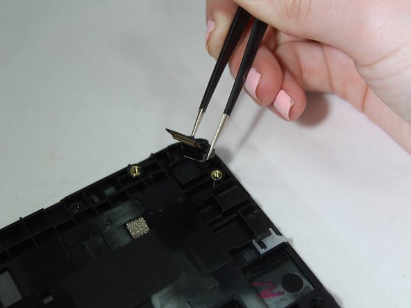

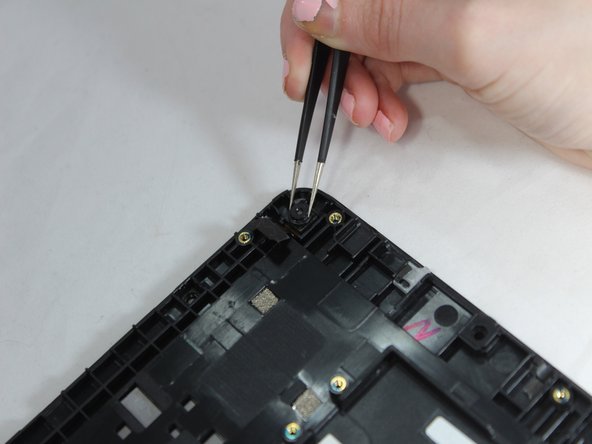

  13. Acer One 10 S1003-114M Rear Camera Replacement, Rear Camera: crwdns2935265:013crwdnd2935265:01crwdnd2935265:03crwdne2935265:0 Acer One 10 S1003-114M Rear Camera Replacement, Rear Camera: crwdns2935265:013crwdnd2935265:02crwdnd2935265:03crwdne2935265:0 Acer One 10 S1003-114M Rear Camera Replacement, Rear Camera: crwdns2935265:013crwdnd2935265:03crwdnd2935265:03crwdne2935265:0
    • Be careful when using tweezers on camera. Clamping tweezers too hard could result in broken glass.
    • Use tweezers to grab the camera's edges and gently lift the camera up from tablet backing.
    • Remove the camera from the device.
