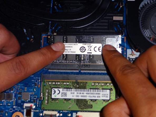

    • Slide the RAM stick into the RAM slot at about a 45 degree angle.
    • Push the RAM stick down until you hear a click.
    • You do need to apply a bit of pressure when pushing down on the RAM.

Once your rear panel is properly put back on, check if your RAM has been installed correctly. Power on your computer. This may take longer than usual because the computer is identifying the new piece of hardware. After your computer has booted up, go to About System (Settings > System > About). Under the “Installed RAM” portion of the page, you will see the amount of RAM your computer has installed. If this amount is correct, you have successfully installed your RAM.
