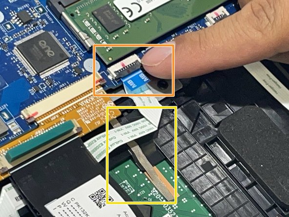

  4. Acer Nitro 5 AN517-51-56YW Touch Pad Replacement, Touch Pad: crwdns2935265:04crwdnd2935265:01crwdnd2935265:02crwdne2935265:0 Acer Nitro 5 AN517-51-56YW Touch Pad Replacement, Touch Pad: crwdns2935265:04crwdnd2935265:02crwdnd2935265:02crwdne2935265:0
    • Remove the two 3.7 mm screws from the silver bracing plate using a Phillips #1 screwdriver.
    • Detach the touch pad connector by lifting the clamp and pulling on the blue tab.
    • Lift the adhesive ribbon to be able to remove the touchpad.
    • Do not remove the ribbon completely, only the part that is on the touchpad.

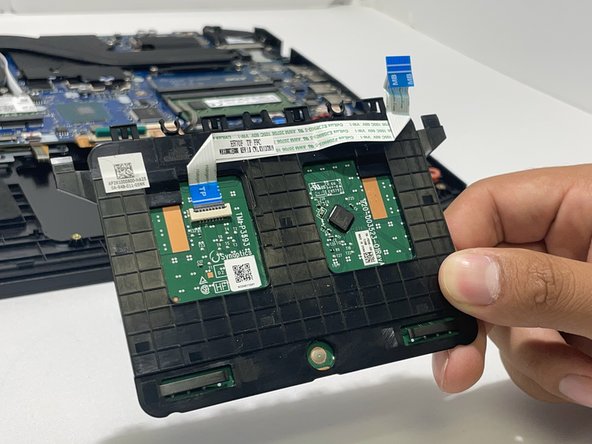

  5. Acer Nitro 5 AN517-51-56YW Touch Pad Replacement: crwdns2935265:05crwdnd2935265:01crwdnd2935265:02crwdne2935265:0 Acer Nitro 5 AN517-51-56YW Touch Pad Replacement: crwdns2935265:05crwdnd2935265:02crwdnd2935265:02crwdne2935265:0
    • Lift the touchpad towards you from the bottom.
