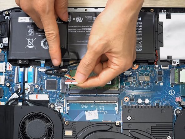

  3. Acer Nitro 5 AN515-55-56GN HDD Replacement: crwdns2935265:03crwdnd2935265:01crwdnd2935265:03crwdne2935265:0 Acer Nitro 5 AN515-55-56GN HDD Replacement: crwdns2935265:03crwdnd2935265:02crwdnd2935265:03crwdne2935265:0 Acer Nitro 5 AN515-55-56GN HDD Replacement: crwdns2935265:03crwdnd2935265:03crwdnd2935265:03crwdne2935265:0
    • Unplug the battery cable from the connector attaching the battery to the motherboard.
    • Make sure that the laptop battery is unplugged or remove the battery before installing the HDD.

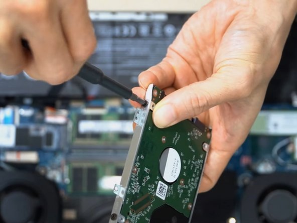

  4. Acer Nitro 5 AN515-55-56GN HDD Replacement: crwdns2935265:04crwdnd2935265:01crwdnd2935265:03crwdne2935265:0 Acer Nitro 5 AN515-55-56GN HDD Replacement: crwdns2935265:04crwdnd2935265:02crwdnd2935265:03crwdne2935265:0 Acer Nitro 5 AN515-55-56GN HDD Replacement: crwdns2935265:04crwdnd2935265:03crwdnd2935265:03crwdne2935265:0
    • Use the Phillips #0 screwdriver to remove four 3 mm screws from the hard drive bracket.
    • Remove the bracket from the device.

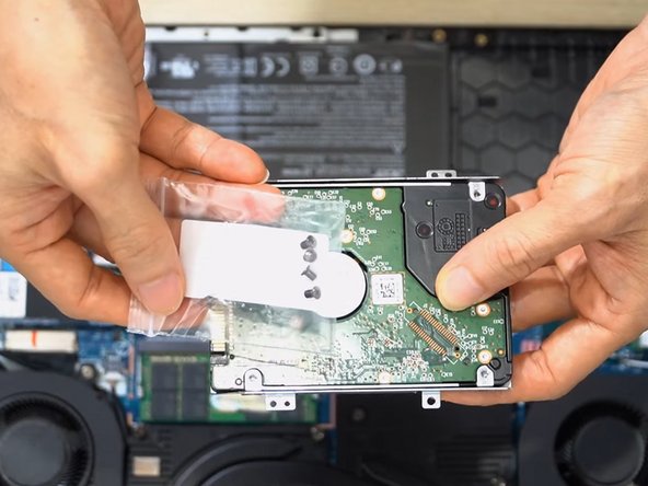

  5. Acer Nitro 5 AN515-55-56GN HDD Replacement: crwdns2935265:05crwdnd2935265:01crwdnd2935265:03crwdne2935265:0 Acer Nitro 5 AN515-55-56GN HDD Replacement: crwdns2935265:05crwdnd2935265:02crwdnd2935265:03crwdne2935265:0 Acer Nitro 5 AN515-55-56GN HDD Replacement: crwdns2935265:05crwdnd2935265:03crwdnd2935265:03crwdne2935265:0
    • Place the HDD 1TB in the bracket.
    • Use the Phillips #0 screwdriver to secure the 2 mm screws that hold the HDD in the bracket.
    • The 2 mm screws are included with the new HDD.

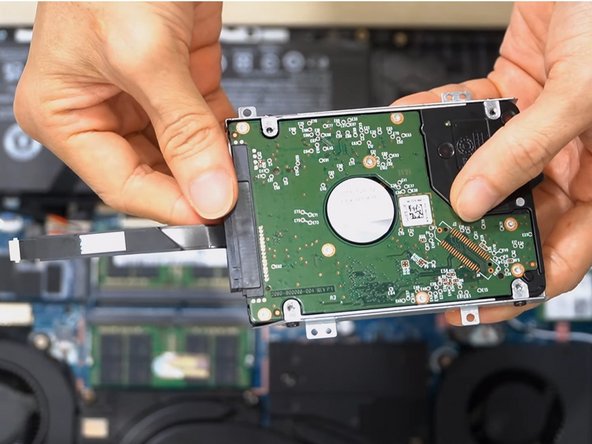

  6. Acer Nitro 5 AN515-55-56GN HDD Replacement: crwdns2935265:06crwdnd2935265:01crwdnd2935265:02crwdne2935265:0 Acer Nitro 5 AN515-55-56GN HDD Replacement: crwdns2935265:06crwdnd2935265:02crwdnd2935265:02crwdne2935265:0
    • Attach the SATA connector to the HDD.
  7. Acer Nitro 5 AN515-55-56GN HDD Replacement: crwdns2935265:07crwdnd2935265:01crwdnd2935265:02crwdne2935265:0 Acer Nitro 5 AN515-55-56GN HDD Replacement: crwdns2935265:07crwdnd2935265:02crwdnd2935265:02crwdne2935265:0
    • Slide the HDD into the socket on the motherboard.
    • Replace the four 3 mm screws using the Phillips #0 screwdriver.

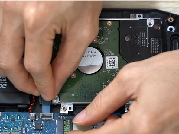

  8. Acer Nitro 5 AN515-55-56GN HDD Replacement: crwdns2935265:08crwdnd2935265:01crwdnd2935265:03crwdne2935265:0 Acer Nitro 5 AN515-55-56GN HDD Replacement: crwdns2935265:08crwdnd2935265:02crwdnd2935265:03crwdne2935265:0 Acer Nitro 5 AN515-55-56GN HDD Replacement: crwdns2935265:08crwdnd2935265:03crwdnd2935265:03crwdne2935265:0
    • Slide the hard drive cable into the connector on the motherboard.
    • Flip the black lock down to secure the cable.
