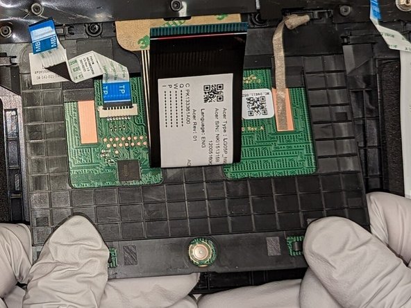

    • Turn the laptop over so its underside is up.
    • Use a Phillips #0 screwdriver to remove all 7 mm screws from the bottom cover.
    • Pop the cover off around the edges.
  2. Acer Nitro 5 AN515-55-55M1 Track Pad Replacement: crwdns2935265:02crwdnd2935265:01crwdnd2935265:02crwdne2935265:0 Acer Nitro 5 AN515-55-55M1 Track Pad Replacement: crwdns2935265:02crwdnd2935265:02crwdnd2935265:02crwdne2935265:0
    • Remove the adhesive from the battery.
    • Use a Phillips #0 screwdriver to remove the two 5 mm screws.
  3. Acer Nitro 5 AN515-55-55M1 Track Pad Replacement: crwdns2935265:03crwdnd2935265:01crwdnd2935265:01crwdne2935265:0
    • Remove the ribbons.
  4. Acer Nitro 5 AN515-55-55M1 Track Pad Replacement: crwdns2935265:04crwdnd2935265:01crwdnd2935265:02crwdne2935265:0 Acer Nitro 5 AN515-55-55M1 Track Pad Replacement: crwdns2935265:04crwdnd2935265:02crwdnd2935265:02crwdne2935265:0
    • Use a Phillips #0 screwdriver to remove the two 3 mm screws.
    • Pull the touchpad up and out of the computer.
