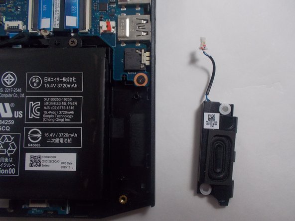

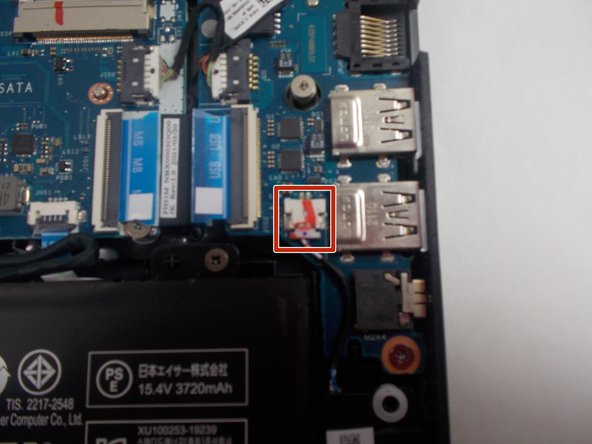

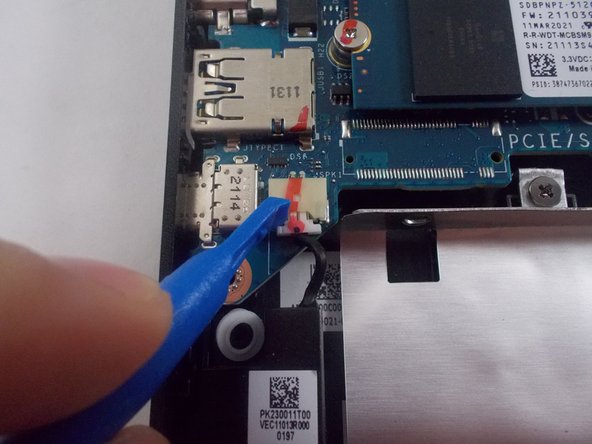

    • Use an iFixit opening tool to unplug both speaker connectors from the motherboard.
  4. Acer Nitro 5 AN515-55-55M1 Speakers Replacement: crwdns2935265:04crwdnd2935265:01crwdnd2935265:02crwdne2935265:0 Acer Nitro 5 AN515-55-55M1 Speakers Replacement: crwdns2935265:04crwdnd2935265:02crwdnd2935265:02crwdne2935265:0
    • Lift the speakers straight up and out of their shells.
