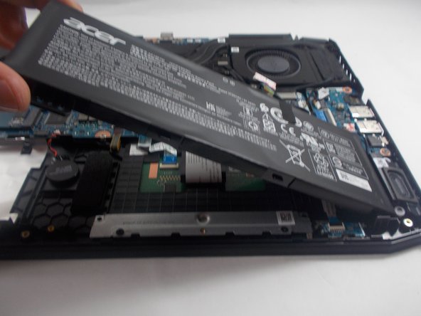

  3. Acer Nitro 5 AN515-55-55M1 Fan Replacement, Battery: crwdns2935265:03crwdnd2935265:01crwdnd2935265:03crwdne2935265:0 Acer Nitro 5 AN515-55-55M1 Fan Replacement, Battery: crwdns2935265:03crwdnd2935265:02crwdnd2935265:03crwdne2935265:0 Acer Nitro 5 AN515-55-55M1 Fan Replacement, Battery: crwdns2935265:03crwdnd2935265:03crwdnd2935265:03crwdne2935265:0
    • Use an opening tool to disconnect the battery from the motherboard.
  4. Acer Nitro 5 AN515-55-55M1 Fan Replacement: crwdns2935265:04crwdnd2935265:01crwdnd2935265:02crwdne2935265:0 Acer Nitro 5 AN515-55-55M1 Fan Replacement: crwdns2935265:04crwdnd2935265:02crwdnd2935265:02crwdne2935265:0
    • Remove the two screws from the battery with a Phillips #1 screwdriver.
    • Remove the battery by pulling up and out from the left side.

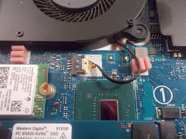

  5. Acer Nitro 5 AN515-55-55M1 Fan Replacement, Motherboard: crwdns2935265:05crwdnd2935265:01crwdnd2935265:03crwdne2935265:0 Acer Nitro 5 AN515-55-55M1 Fan Replacement, Motherboard: crwdns2935265:05crwdnd2935265:02crwdnd2935265:03crwdne2935265:0 Acer Nitro 5 AN515-55-55M1 Fan Replacement, Motherboard: crwdns2935265:05crwdnd2935265:03crwdnd2935265:03crwdne2935265:0
    • Disconnect the seven cables from the motherboard using an iFixit opening tool.
  6. Acer Nitro 5 AN515-55-55M1 Fan Replacement: crwdns2935265:06crwdnd2935265:01crwdnd2935265:03crwdne2935265:0 Acer Nitro 5 AN515-55-55M1 Fan Replacement: crwdns2935265:06crwdnd2935265:02crwdnd2935265:03crwdne2935265:0 Acer Nitro 5 AN515-55-55M1 Fan Replacement: crwdns2935265:06crwdnd2935265:03crwdnd2935265:03crwdne2935265:0
    • Use an iFixit opening tool to lift the two Wi-Fi antenna cables up and away from the Wi-Fi card.
  7. Acer Nitro 5 AN515-55-55M1 Fan Replacement: crwdns2935265:07crwdnd2935265:01crwdnd2935265:03crwdne2935265:0 Acer Nitro 5 AN515-55-55M1 Fan Replacement: crwdns2935265:07crwdnd2935265:02crwdnd2935265:03crwdne2935265:0 Acer Nitro 5 AN515-55-55M1 Fan Replacement: crwdns2935265:07crwdnd2935265:03crwdnd2935265:03crwdne2935265:0
    • Remove the six screws surrounding the fan using a Phillips #1 screwdriver.
    • Remove the two shorter screws from the motherboard using a Phillips #1 screwdriver.
    • Lift the taped wires off of the fans on the right and left sides.

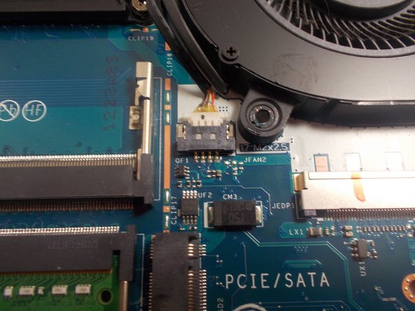

  9. Acer Nitro 5 AN515-55-55M1 Fan Replacement, Fan: crwdns2935265:09crwdnd2935265:01crwdnd2935265:03crwdne2935265:0 Acer Nitro 5 AN515-55-55M1 Fan Replacement, Fan: crwdns2935265:09crwdnd2935265:02crwdnd2935265:03crwdne2935265:0 Acer Nitro 5 AN515-55-55M1 Fan Replacement, Fan: crwdns2935265:09crwdnd2935265:03crwdnd2935265:03crwdne2935265:0
    • Unplug the two fan connectors from each side of the motherboard using an opening tool.

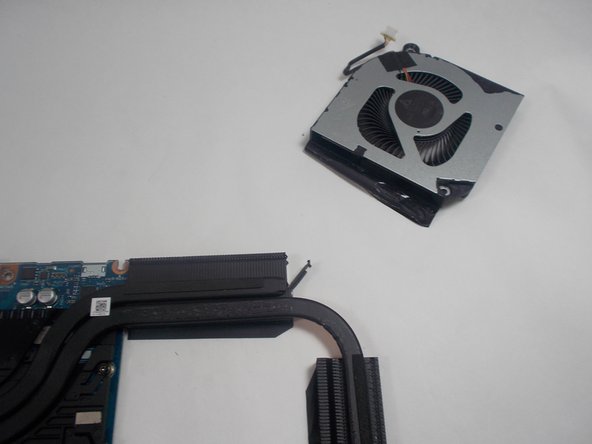

    • Both fans are loose at this point and are only being held in by thermal tape.
    • Lift both fans up on each side and fold over the heat pipe.
  11. Acer Nitro 5 AN515-55-55M1 Fan Replacement: crwdns2935265:011crwdnd2935265:01crwdnd2935265:02crwdne2935265:0 Acer Nitro 5 AN515-55-55M1 Fan Replacement: crwdns2935265:011crwdnd2935265:02crwdnd2935265:02crwdne2935265:0
    • Pull the fan away from the heat pipe on both sides of the motherboard.
    • The tape will separate off of the heat pipe.
