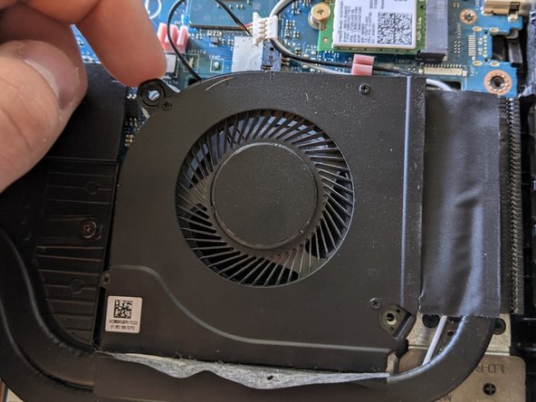

    • Detach the fan's wire connector from the motherboard.
  5. Acer Nitro 5 AN515-55-53AG Internal Fan Replacement: crwdns2935265:05crwdnd2935265:01crwdnd2935265:01crwdne2935265:0
    • Peel up the two strips of black tape holding the fan.
    • Do not peel the tape all the way off. Leave the tape attached to the heatsink.
  6. Acer Nitro 5 AN515-55-53AG Internal Fan Replacement: crwdns2935265:06crwdnd2935265:01crwdnd2935265:03crwdne2935265:0 Acer Nitro 5 AN515-55-53AG Internal Fan Replacement: crwdns2935265:06crwdnd2935265:02crwdnd2935265:03crwdne2935265:0 Acer Nitro 5 AN515-55-53AG Internal Fan Replacement: crwdns2935265:06crwdnd2935265:03crwdnd2935265:03crwdne2935265:0

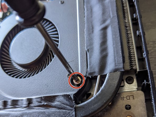

    • Remove the two screws holding the fan in place using a Phillips #0 screwdriver.
    • Remove the old fan by pulling it directly up.
  7. Acer Nitro 5 AN515-55-53AG Internal Fan Replacement: crwdns2935265:07crwdnd2935265:01crwdnd2935265:02crwdne2935265:0 Acer Nitro 5 AN515-55-53AG Internal Fan Replacement: crwdns2935265:07crwdnd2935265:02crwdnd2935265:02crwdne2935265:0
    • While the fan is out, clean the space with a cloth or a can of compressed air. Clean the fan vents and plate of any dust.
