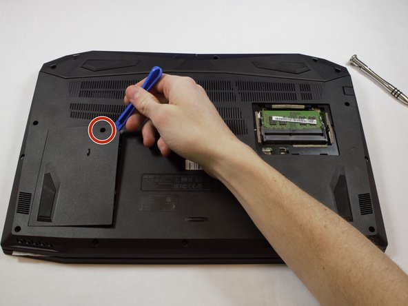

    • Use the Phillips #0 screwdriver to remove the 9mm screw in the bottom left corner of the RAM tray covering.
    • Remove the RAM tray cover by prying it up with a plastic opening tool.

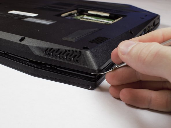

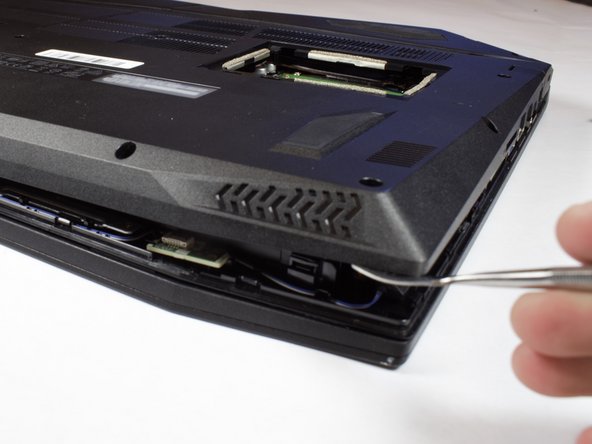

  5. Acer Nitro 5 AN515-53-55G9 Wi-Fi Card Replacement: crwdns2935265:05crwdnd2935265:01crwdnd2935265:03crwdne2935265:0 Acer Nitro 5 AN515-53-55G9 Wi-Fi Card Replacement: crwdns2935265:05crwdnd2935265:02crwdnd2935265:03crwdne2935265:0 Acer Nitro 5 AN515-53-55G9 Wi-Fi Card Replacement: crwdns2935265:05crwdnd2935265:03crwdnd2935265:03crwdne2935265:0
    • Carefully remove the back shell from the device by prying at the creases with a spudger around all the edges.
    • Do not forcefully try to separate the shell as you may cause harm to the shell.
  6. Acer Nitro 5 AN515-53-55G9 Wi-Fi Card Replacement: crwdns2935265:06crwdnd2935265:01crwdnd2935265:01crwdne2935265:0
    • Lift the back cover off once all the clips have been disengaged.
