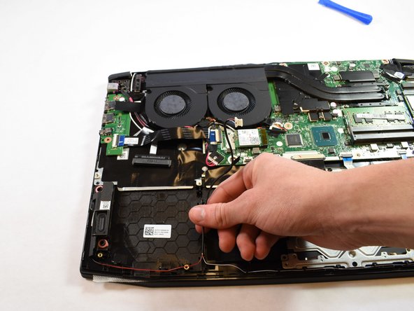

    • Removing the back shell of the computer and it will look like this.
    • The battery for the device is located at the bottom middle of the laptop at this orientation.

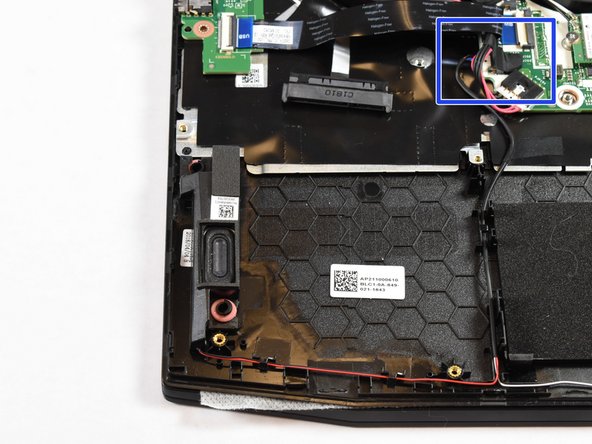

    • Once the battery is removed your device should look similar to this.
    • Locate the plug for the speakers located at the red circle.

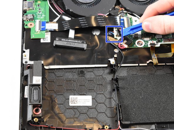

    • Unplug the cable from the motherboard as shown.
    • Carefully unroute the cables starting from the main plug.
    • Do not forcefully pull on the cable as it might break the cable.

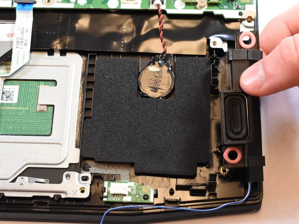

    • Locate the Right Speaker on the device.
    • Pull up on the speaker to remove from the device.
    • Rubber grommets from the speaker my pop off. These can easily be placed back on.
