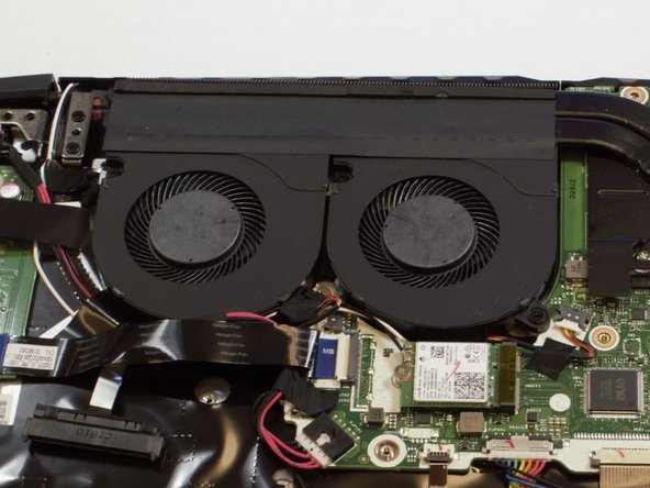

    • The fan for the device is located at the top left of the laptop at this orientation.
  7. Acer Nitro 5 AN515-53-55G9 Fan Replacement: crwdns2935265:07crwdnd2935265:01crwdnd2935265:03crwdne2935265:0 Acer Nitro 5 AN515-53-55G9 Fan Replacement: crwdns2935265:07crwdnd2935265:02crwdnd2935265:03crwdne2935265:0 Acer Nitro 5 AN515-53-55G9 Fan Replacement: crwdns2935265:07crwdnd2935265:03crwdnd2935265:03crwdne2935265:0

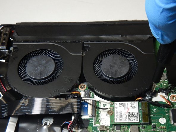

    • Using your fingers, slide out the two fan cables from their connectors on the motherboard.
  8. Acer Nitro 5 AN515-53-55G9 Fan Replacement: crwdns2935265:08crwdnd2935265:01crwdnd2935265:03crwdne2935265:0 Acer Nitro 5 AN515-53-55G9 Fan Replacement: crwdns2935265:08crwdnd2935265:02crwdnd2935265:03crwdne2935265:0 Acer Nitro 5 AN515-53-55G9 Fan Replacement: crwdns2935265:08crwdnd2935265:03crwdnd2935265:03crwdne2935265:0
    • Use the Phillips #0 screwdriver to remove the four 9 mm screws holding the fan assembly in place.
  9. Acer Nitro 5 AN515-53-55G9 Fan Replacement: crwdns2935265:09crwdnd2935265:01crwdnd2935265:03crwdne2935265:0 Acer Nitro 5 AN515-53-55G9 Fan Replacement: crwdns2935265:09crwdnd2935265:02crwdnd2935265:03crwdne2935265:0 Acer Nitro 5 AN515-53-55G9 Fan Replacement: crwdns2935265:09crwdnd2935265:03crwdnd2935265:03crwdne2935265:0
    • Gently remove the fans.
