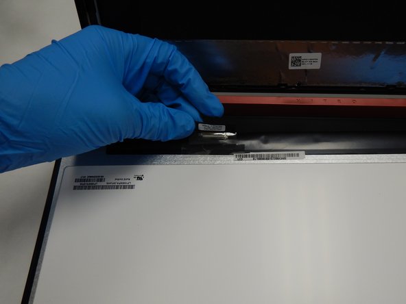

    • Make sure laptop is off and unplugged before beginning replacement.
    • Open the laptop so the display is facing you.
  2. Acer Nitro 5 AN515-53-55G9 Display Replacement: crwdns2935265:02crwdnd2935265:01crwdnd2935265:03crwdne2935265:0 Acer Nitro 5 AN515-53-55G9 Display Replacement: crwdns2935265:02crwdnd2935265:02crwdnd2935265:03crwdne2935265:0 Acer Nitro 5 AN515-53-55G9 Display Replacement: crwdns2935265:02crwdnd2935265:03crwdnd2935265:03crwdne2935265:0
    • Pry open the plastic bezel around the screen by going around all four sides with a plastic opening tool.
  3. Acer Nitro 5 AN515-53-55G9 Display Replacement: crwdns2935265:03crwdnd2935265:01crwdnd2935265:03crwdne2935265:0 Acer Nitro 5 AN515-53-55G9 Display Replacement: crwdns2935265:03crwdnd2935265:02crwdnd2935265:03crwdne2935265:0 Acer Nitro 5 AN515-53-55G9 Display Replacement: crwdns2935265:03crwdnd2935265:03crwdnd2935265:03crwdne2935265:0
    • Remove the four 9 mm screws holding the display in place with a Phillips #0 screwdriver.
    • Carefully lower the display to rest on the keyboard.

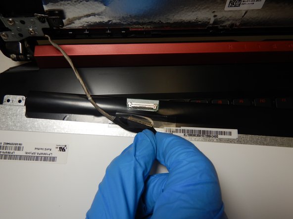

  4. Acer Nitro 5 AN515-53-55G9 Display Replacement: crwdns2935265:04crwdnd2935265:01crwdnd2935265:03crwdne2935265:0 Acer Nitro 5 AN515-53-55G9 Display Replacement: crwdns2935265:04crwdnd2935265:02crwdnd2935265:03crwdne2935265:0 Acer Nitro 5 AN515-53-55G9 Display Replacement: crwdns2935265:04crwdnd2935265:03crwdnd2935265:03crwdne2935265:0
    • Disconnect the display connector from the display.
    • Remove the display.

This guide was helpful in replacing the screen in my son’s Acer Nitro 5 AN515--43-R0YM, with a slight difference. That model’s screen is held in place with adhesive strips, not screws. Kind of pain, but not too bad to deal with. The strips work basically like 3M Command Strips. Use pliers are strong tweezers to grab the tab peeking out from behind the screen at each corner (but do one at a time, of course), and _slowly_ pull straight out (parallel to the screen). Once enough has come out, grab with your fingers and keep pulling _slowly_. If you pull too fast it could break, and then you’ve got a real headache on your hands. Be patient and eventually the tape will release.
