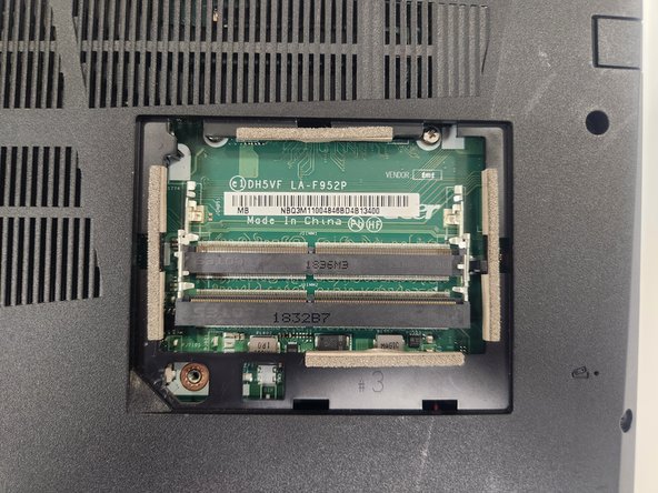

    • Make sure the laptop is off and unplugged before starting.
    • Flip the laptop upside down so the bottom is facing up.
    • Identify the RAM tray on the bottom of the laptop.
  2. Acer Nitro 5 AN515-53-52FA RAM Replacement: crwdns2935265:02crwdnd2935265:01crwdnd2935265:03crwdne2935265:0 Acer Nitro 5 AN515-53-52FA RAM Replacement: crwdns2935265:02crwdnd2935265:02crwdnd2935265:03crwdne2935265:0 Acer Nitro 5 AN515-53-52FA RAM Replacement: crwdns2935265:02crwdnd2935265:03crwdnd2935265:03crwdne2935265:0
    • Use the Phillips #0 screwdriver to remove the single 9mm screw holding the tray in place.
    • Remove the RAM tray cover by prying on the opening with a spudger.
  3. Acer Nitro 5 AN515-53-52FA RAM Replacement: crwdns2935265:03crwdnd2935265:01crwdnd2935265:02crwdne2935265:0 Acer Nitro 5 AN515-53-52FA RAM Replacement: crwdns2935265:03crwdnd2935265:02crwdnd2935265:02crwdne2935265:0
    • Locate the silver clips holding the RAM in place
    • Push the silver clips down away from the RAM. The ram should pop out at an angle.

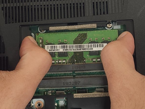

  4. Acer Nitro 5 AN515-53-52FA RAM Replacement: crwdns2935265:04crwdnd2935265:01crwdnd2935265:02crwdne2935265:0 Acer Nitro 5 AN515-53-52FA RAM Replacement: crwdns2935265:04crwdnd2935265:02crwdnd2935265:02crwdne2935265:0
    • Gently slide RAM out of the slot.
    • When inserting new RAM make sure to install it in the correct orientation.
