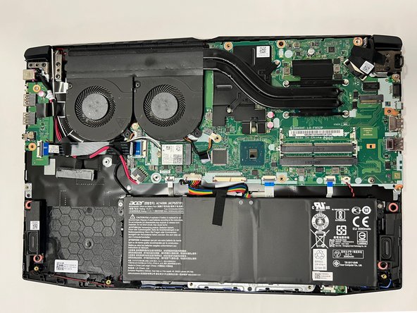

    • Removing the backshell of the laptop will reveal the inside of it.
    • The fan of the laptop is located on the top left of the laptop.

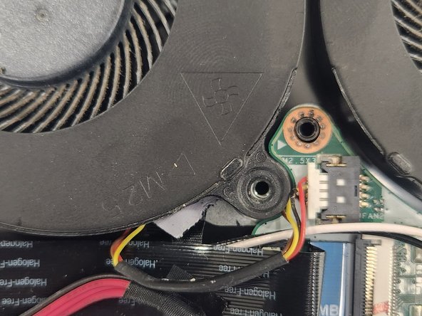

  4. Acer Nitro 5 AN515-53-52FA Fan Replacement: crwdns2935265:04crwdnd2935265:01crwdnd2935265:02crwdne2935265:0 Acer Nitro 5 AN515-53-52FA Fan Replacement: crwdns2935265:04crwdnd2935265:02crwdnd2935265:02crwdne2935265:0
    • Use the Phillips #0 screwdriver to remove the four 9 mm screws securing the fans.

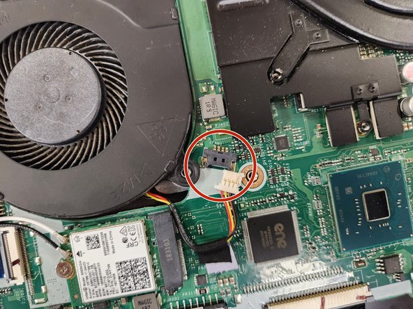

  5. Acer Nitro 5 AN515-53-52FA Fan Replacement: crwdns2935265:05crwdnd2935265:01crwdnd2935265:03crwdne2935265:0 Acer Nitro 5 AN515-53-52FA Fan Replacement: crwdns2935265:05crwdnd2935265:02crwdnd2935265:03crwdne2935265:0 Acer Nitro 5 AN515-53-52FA Fan Replacement: crwdns2935265:05crwdnd2935265:03crwdnd2935265:03crwdne2935265:0
    • Unplug the connectors before taking the fan out.
