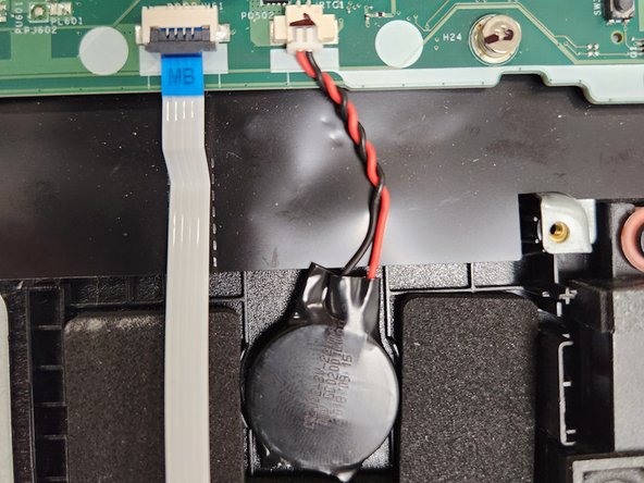

    • Locate the CMOS that is under the battery.
  8. Acer Nitro 5 AN515-53-52FA CMOS Replacement: crwdns2935265:08crwdnd2935265:01crwdnd2935265:02crwdne2935265:0 Acer Nitro 5 AN515-53-52FA CMOS Replacement: crwdns2935265:08crwdnd2935265:02crwdnd2935265:02crwdne2935265:0

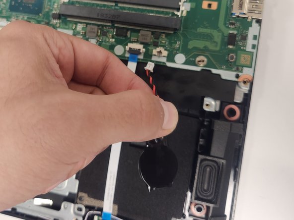

    • Gently unplug the port.
  9. Acer Nitro 5 AN515-53-52FA CMOS Replacement: crwdns2935265:09crwdnd2935265:01crwdnd2935265:02crwdne2935265:0 Acer Nitro 5 AN515-53-52FA CMOS Replacement: crwdns2935265:09crwdnd2935265:02crwdnd2935265:02crwdne2935265:0
    • Carefully pull the CMOS Battery, as there is adhesive keeping it attached.
