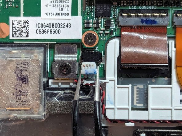

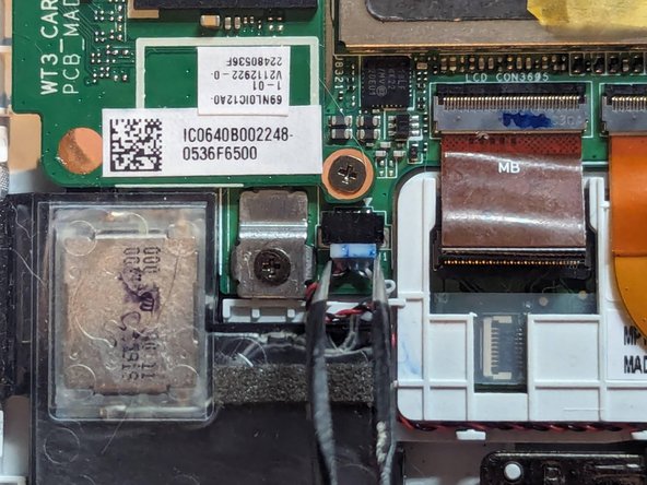

  13. Acer Iconia W510 Speaker Replacement, Speakers: crwdns2935265:013crwdnd2935265:01crwdnd2935265:03crwdne2935265:0 Acer Iconia W510 Speaker Replacement, Speakers: crwdns2935265:013crwdnd2935265:02crwdnd2935265:03crwdne2935265:0 Acer Iconia W510 Speaker Replacement, Speakers: crwdns2935265:013crwdnd2935265:03crwdnd2935265:03crwdne2935265:0
    • Unplug the speakers.
    • Grasp the connector itself; do not pull on the wires to unplug the speakers.

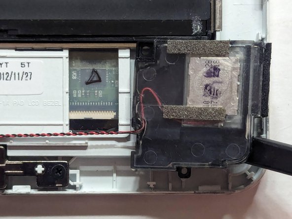

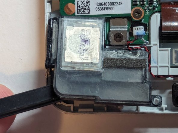

  14. Acer Iconia W510 Speaker Replacement, Remove the Right Speaker: crwdns2935265:014crwdnd2935265:01crwdnd2935265:03crwdne2935265:0 Acer Iconia W510 Speaker Replacement, Remove the Right Speaker: crwdns2935265:014crwdnd2935265:02crwdnd2935265:03crwdne2935265:0 Acer Iconia W510 Speaker Replacement, Remove the Right Speaker: crwdns2935265:014crwdnd2935265:03crwdnd2935265:03crwdne2935265:0
    • The speaker is lightly adhered to the case with double sided tape. Use a spudger to pry the speaker up to remove it.

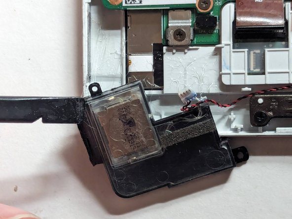

  15. Acer Iconia W510 Speaker Replacement, Remove the Left Speaker: crwdns2935265:015crwdnd2935265:01crwdnd2935265:03crwdne2935265:0 Acer Iconia W510 Speaker Replacement, Remove the Left Speaker: crwdns2935265:015crwdnd2935265:02crwdnd2935265:03crwdne2935265:0 Acer Iconia W510 Speaker Replacement, Remove the Left Speaker: crwdns2935265:015crwdnd2935265:03crwdnd2935265:03crwdne2935265:0
    • Repeat for the left speaker.

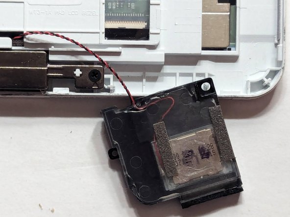

  16. Acer Iconia W510 Speaker Replacement, Deroute the Speaker Wires: crwdns2935265:016crwdnd2935265:01crwdnd2935265:01crwdne2935265:0
    • Starting at the left speaker, lift the wire out of the channel it sits in.
  17. Acer Iconia W510 Speaker Replacement: crwdns2935265:017crwdnd2935265:01crwdnd2935265:01crwdne2935265:0
    • Fold the charging port flex cable back to clear the speaker cable channel.
  18. Acer Iconia W510 Speaker Replacement: crwdns2935265:018crwdnd2935265:01crwdnd2935265:01crwdne2935265:0
    • One last tab to clear.
  19. Acer Iconia W510 Speaker Replacement: crwdns2935265:019crwdnd2935265:01crwdnd2935265:01crwdne2935265:0
    • And the speakers are free.
