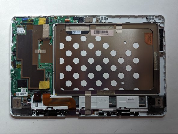

  6. Acer Iconia W510 Battery Replacement: crwdns2935265:06crwdnd2935265:01crwdnd2935265:01crwdne2935265:0
    • The rear cover is removed.

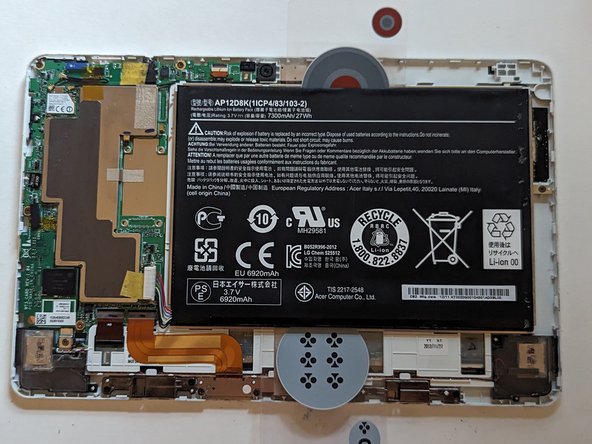

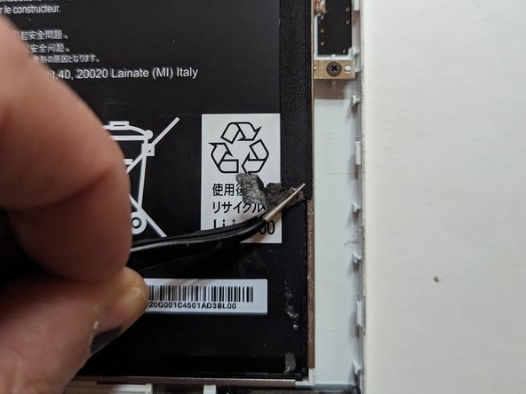

  9. Acer Iconia W510 Battery Replacement, Battery: crwdns2935265:09crwdnd2935265:01crwdnd2935265:03crwdne2935265:0 Acer Iconia W510 Battery Replacement, Battery: crwdns2935265:09crwdnd2935265:02crwdnd2935265:03crwdne2935265:0 Acer Iconia W510 Battery Replacement, Battery: crwdns2935265:09crwdnd2935265:03crwdnd2935265:03crwdne2935265:0
    • Remove the tape on the right side of the battery securing it to the tray.
  10. Acer Iconia W510 Battery Replacement: crwdns2935265:010crwdnd2935265:01crwdnd2935265:01crwdne2935265:0
    • Note the position of three strips of adhesive holding the battery in place.

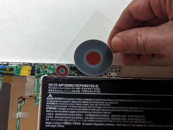

  11. Acer Iconia W510 Battery Replacement: crwdns2935265:011crwdnd2935265:01crwdnd2935265:03crwdne2935265:0 Acer Iconia W510 Battery Replacement: crwdns2935265:011crwdnd2935265:02crwdnd2935265:03crwdne2935265:0 Acer Iconia W510 Battery Replacement: crwdns2935265:011crwdnd2935265:03crwdnd2935265:03crwdne2935265:0
    • Using a flexible piece of plastic, slip it under the battery and use it to slice the first adhesive strip.
    • Leave it in place while slicing the remaining strips.
  12. Acer Iconia W510 Battery Replacement: crwdns2935265:012crwdnd2935265:01crwdnd2935265:02crwdne2935265:0 Acer Iconia W510 Battery Replacement: crwdns2935265:012crwdnd2935265:02crwdnd2935265:02crwdne2935265:0
    • Do the same with the second piece of adhesive.
    • Leave the card in place again.
  13. Acer Iconia W510 Battery Replacement: crwdns2935265:013crwdnd2935265:01crwdnd2935265:02crwdne2935265:0 Acer Iconia W510 Battery Replacement: crwdns2935265:013crwdnd2935265:02crwdnd2935265:02crwdne2935265:0
    • And finally, slice the third adhesive strip.
  14. Acer Iconia W510 Battery Replacement: crwdns2935265:014crwdnd2935265:01crwdnd2935265:02crwdne2935265:0 Acer Iconia W510 Battery Replacement: crwdns2935265:014crwdnd2935265:02crwdnd2935265:02crwdne2935265:0
    • The battery can now be lifted out of the tablet.
  15. Acer Iconia W510 Battery Replacement: crwdns2935265:015crwdnd2935265:01crwdnd2935265:01crwdne2935265:0
    • The battery is now free.
