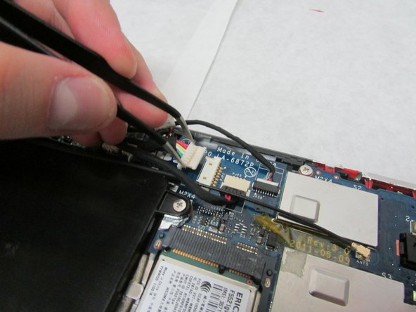

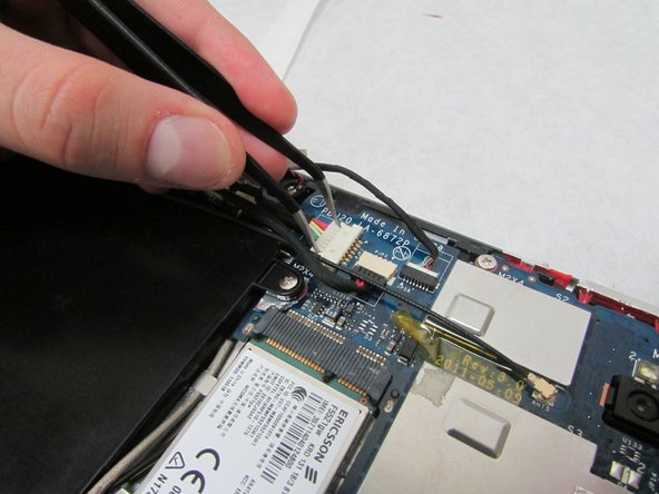

    • In the next step, be careful not to squeeze too hard or scratch the motherboard.
    • Use the angled tweezers to disconnect the motherboard-battery cable from the white connector in the middle of the side opposite the docking port.

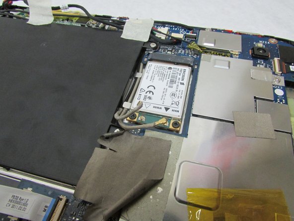

    • Remove all tape covering the wireless adapter.
  5. Acer Iconia Tab A501 Wireless Adapter Replacement: crwdns2935265:05crwdnd2935265:01crwdnd2935265:03crwdne2935265:0 Acer Iconia Tab A501 Wireless Adapter Replacement: crwdns2935265:05crwdnd2935265:02crwdnd2935265:03crwdne2935265:0 Acer Iconia Tab A501 Wireless Adapter Replacement: crwdns2935265:05crwdnd2935265:03crwdnd2935265:03crwdne2935265:0

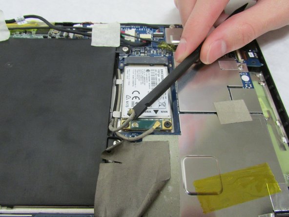

    • Use the flat end of the standard Spudger to disconnect the two small rotatable connectors attached to the wireless adapter.

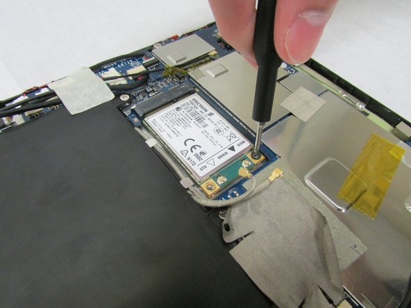

    • Use a Phillips #1 screwdriver to remove the two 3.0 mm Philips head screws holding the adapter down.

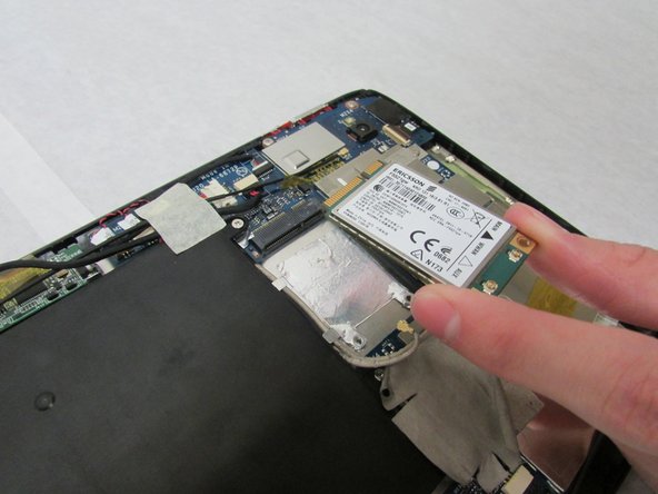

    • Carefully slide the adapter out to remove it.
