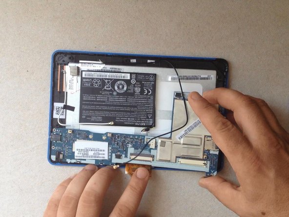

    • First, disconnect the battery.
    • Now, disconnect the loudspeaker and remove the back cover.
    • Remove all scotch tapes and disconnect the touch screen flex cable...
    • LCD display flex cable,
    • the microphone,
    • and the WiFi and Bluetooth antennas flex cables.

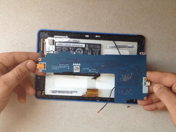

    • Unscrew 5x screws and rmove the main board.

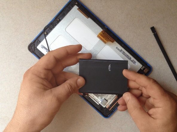

    • The battery is glued to the LCD display metal shield with a double sided adhesive tape.
    • Use plastic tools and carefully remove it.

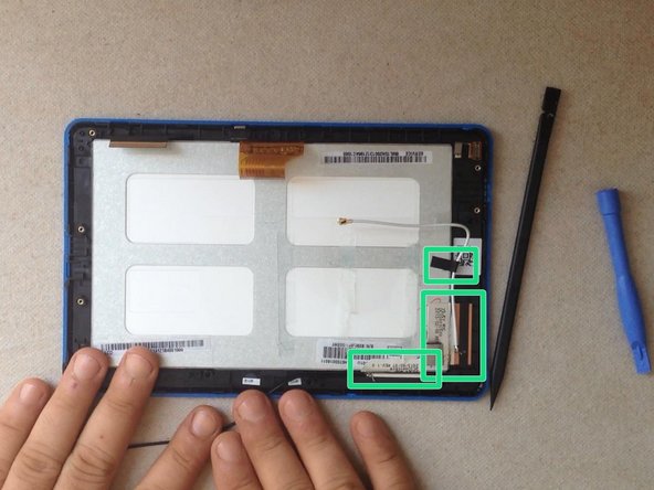

    • Remove all tapes from the LCD display metal shield.

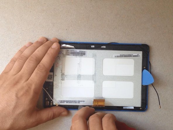

    • The LCD display is held by metal frame and some locking clips on it.
    • Use a cutter and a plastic tool to separate the LCD.
    • You have to work slowly so as not to break the display.
    • Now, install the new LCD display and reassemble the tablet.
