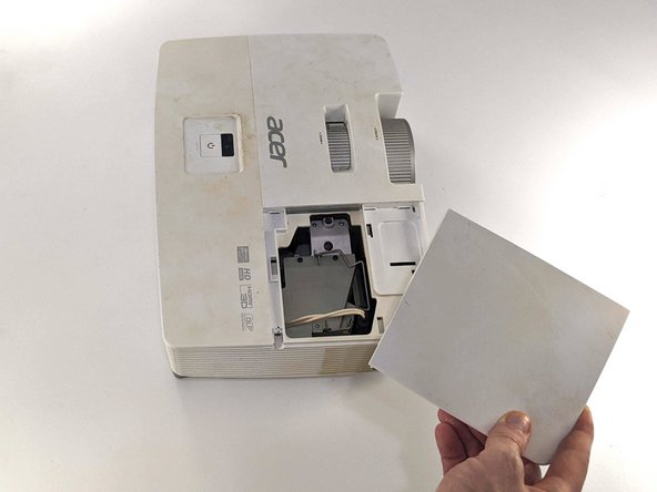

  3. Acer H5380BD Lamp Replacement: crwdns2935265:03crwdnd2935265:01crwdnd2935265:02crwdne2935265:0 Acer H5380BD Lamp Replacement: crwdns2935265:03crwdnd2935265:02crwdnd2935265:02crwdne2935265:0
    • Slide the top plate away from the center of the projector by about a centimeter.
    • Lift the top plate off of the projector.

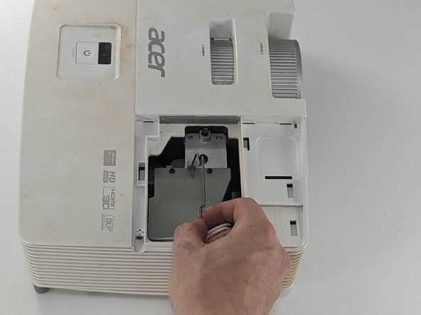

  5. Acer H5380BD Lamp Replacement: crwdns2935265:05crwdnd2935265:01crwdnd2935265:02crwdne2935265:0 Acer H5380BD Lamp Replacement: crwdns2935265:05crwdnd2935265:02crwdnd2935265:02crwdne2935265:0
    • Unplug the cable connecting the projector to the lamp module from its socket using your fingers.
  6. Acer H5380BD Lamp Replacement: crwdns2935265:06crwdnd2935265:01crwdnd2935265:03crwdne2935265:0 Acer H5380BD Lamp Replacement: crwdns2935265:06crwdnd2935265:02crwdnd2935265:03crwdne2935265:0 Acer H5380BD Lamp Replacement: crwdns2935265:06crwdnd2935265:03crwdnd2935265:03crwdne2935265:0
    • Lift the swinging handle on the lamp module using your fingers.
    • Pull straight up on the swinging handle to remove the lamp module from the projector.
    • Place the removed lamp module in a safe location.
    • The lamp module includes a glass bulb containing mercury. Handle the lamp module with care to avoid shattering the bulb.

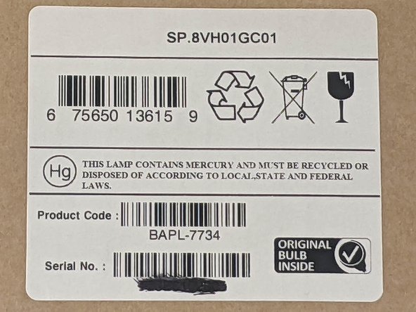

  7. Acer H5380BD Lamp Replacement: crwdns2935265:07crwdnd2935265:01crwdnd2935265:03crwdne2935265:0 Acer H5380BD Lamp Replacement: crwdns2935265:07crwdnd2935265:02crwdnd2935265:03crwdne2935265:0 Acer H5380BD Lamp Replacement: crwdns2935265:07crwdnd2935265:03crwdnd2935265:03crwdne2935265:0
    • Carefully remove the replacement lamp module from its packaging.
    • Take care not touch the lens while handling the replacement lamp module so that you don't get it dirty.
    • Oil or dirt from your hands can leave smears on the lens, which will decrease the quality of the projected image.
  8. Acer H5380BD Lamp Replacement: crwdns2935265:08crwdnd2935265:01crwdnd2935265:02crwdne2935265:0 Acer H5380BD Lamp Replacement: crwdns2935265:08crwdnd2935265:02crwdnd2935265:02crwdne2935265:0
    • Package the old lamp module using packaging appropriate for fragile items, like the box that the replacement lamp module came in.
    • Dispose of the old lamp module in accordance with local, state, and federal laws by giving it to a local recycling center or shipping it to a lamp recycling center.
