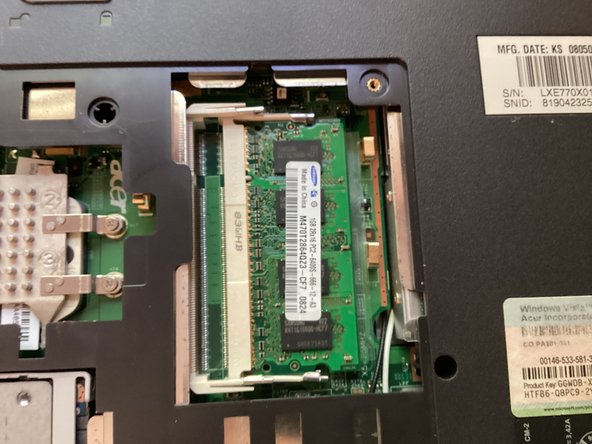

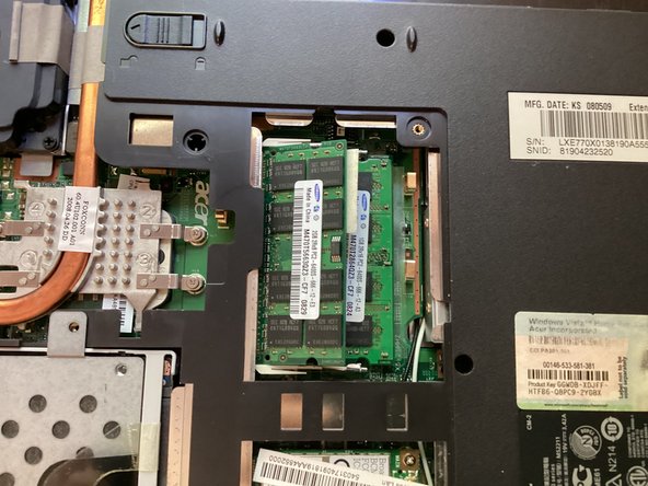

    1. Acer Extensa 4420 RAM Replacement, RAM: crwdns2935265:05crwdnd2935265:01crwdnd2935265:03crwdne2935265:0 Acer Extensa 4420 RAM Replacement, RAM: crwdns2935265:05crwdnd2935265:02crwdnd2935265:03crwdne2935265:0 Acer Extensa 4420 RAM Replacement, RAM: crwdns2935265:05crwdnd2935265:03crwdnd2935265:03crwdne2935265:0
      • Push the clips in red towards the outside. Doing so will release the RAM. Pull the RAM out.
      • Do this for both RAM modules
