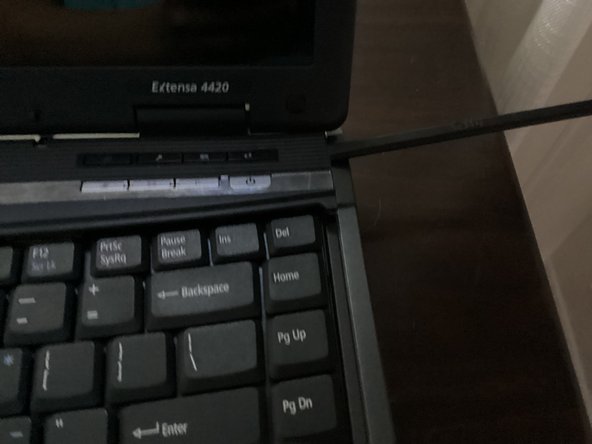

  3. Acer Extensa 4420 Keyboard Replacement, Keyboard Cover: crwdns2935265:03crwdnd2935265:01crwdnd2935265:03crwdne2935265:0 Acer Extensa 4420 Keyboard Replacement, Keyboard Cover: crwdns2935265:03crwdnd2935265:02crwdnd2935265:03crwdne2935265:0 Acer Extensa 4420 Keyboard Replacement, Keyboard Cover: crwdns2935265:03crwdnd2935265:03crwdnd2935265:03crwdne2935265:0
    Spudger
    $3.99

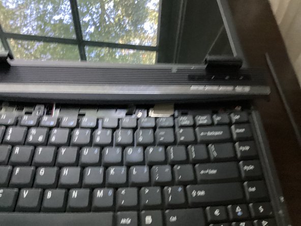

    • Open the keyboard cover with a spudger
    • You will need to fold the display all the way back, or else the keyboard cover will get stuck on it.

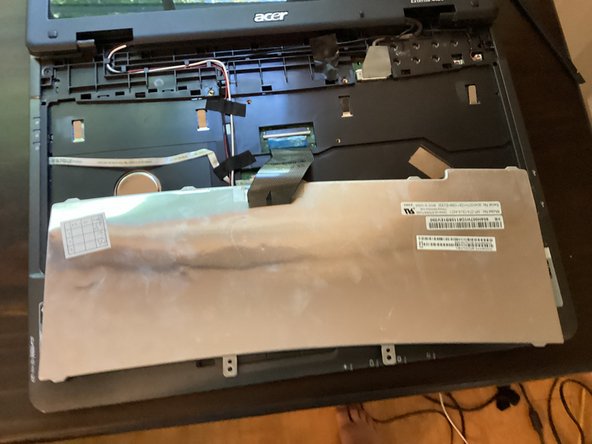

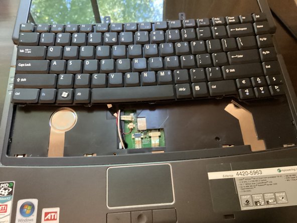

    • Unscrew these 2 screws with a phillips #000 screwdriver.
    • Pull the keyboard out. It should come out pretty easily.

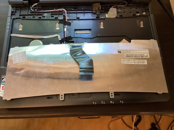

    • DO NOT PULL IT OUT TOO HARD, AS YOU WOULD BREAK THE RIBBON CABLE!
    • Flip the keyboard around, so you have access to the ribbon cable on the back of the keyboard

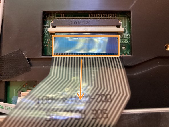

  5. Acer Extensa 4420 Keyboard Replacement: crwdns2935265:05crwdnd2935265:01crwdnd2935265:03crwdne2935265:0 Acer Extensa 4420 Keyboard Replacement: crwdns2935265:05crwdnd2935265:02crwdnd2935265:03crwdne2935265:0 Acer Extensa 4420 Keyboard Replacement: crwdns2935265:05crwdnd2935265:03crwdnd2935265:03crwdne2935265:0
    • Pull the white part of the connector towards you.
    • Doing so will unlock the ribbon cable.
    • Take the blue tag and pull it towards you.
