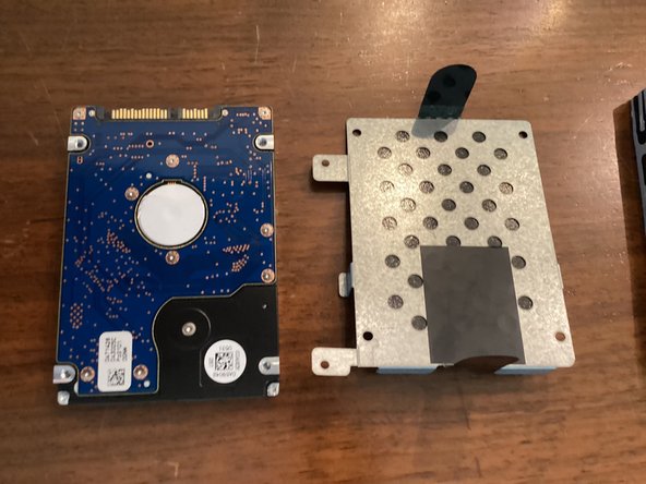

    • With the hard drive out of the computer, we can start disassembling it.
    • Unscrew these 2 screws with a phillips screwdriver
    • The hard drive is a fragile part. Be careful when handling it.

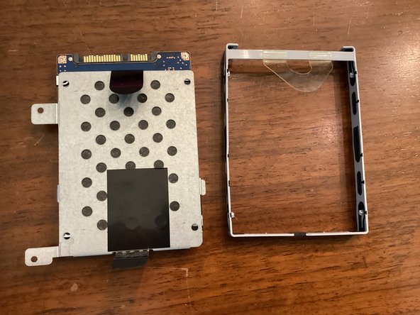

  8. Acer Extensa 4420 Hard Drive Dissasembly, Plastic Case: crwdns2935265:08crwdnd2935265:01crwdnd2935265:02crwdne2935265:0 Acer Extensa 4420 Hard Drive Dissasembly, Plastic Case: crwdns2935265:08crwdnd2935265:02crwdnd2935265:02crwdne2935265:0
    • Then, separate the plastic case from the hard drive in the places indicated.
    • After, the whole plastic case should come off.
  9. Acer Extensa 4420 Hard Drive Dissasembly, Metal Plate: crwdns2935265:09crwdnd2935265:01crwdnd2935265:02crwdne2935265:0 Acer Extensa 4420 Hard Drive Dissasembly, Metal Plate: crwdns2935265:09crwdnd2935265:02crwdnd2935265:02crwdne2935265:0
    • Take the metal plate off with the pull tab indicated.
    • Be super careful after taking the metal plate off. Under the plate are exposed internals, which can be damaged easily.
