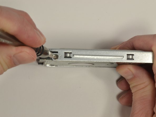

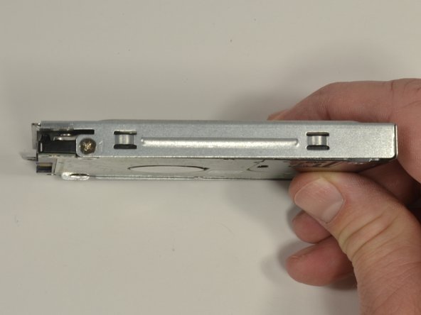

  24. Acer E5-571-54FL RAM Replacement: crwdns2935265:024crwdnd2935265:01crwdnd2935265:03crwdne2935265:0 Acer E5-571-54FL RAM Replacement: crwdns2935265:024crwdnd2935265:02crwdnd2935265:03crwdne2935265:0 Acer E5-571-54FL RAM Replacement: crwdns2935265:024crwdnd2935265:03crwdnd2935265:03crwdne2935265:0
    • Hold the hard drive carriage with your non-dominant hand along one side. Ensure one of the Phillips screws is visible.
    • Using a Phillips #0 screwdriver, remove the 3 mm screw to release the side of the hard drive from the carriage.
    • Repeat the previous bullet to remove the second 3 mm Phillips #0 screw.

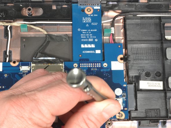

  25. Acer E5-571-54FL RAM Replacement, Motherboard: crwdns2935265:025crwdnd2935265:01crwdnd2935265:02crwdne2935265:0 Acer E5-571-54FL RAM Replacement, Motherboard: crwdns2935265:025crwdnd2935265:02crwdnd2935265:02crwdne2935265:0
    • Use a Phillips #0 screwdriver to remove the two 4 mm screws.

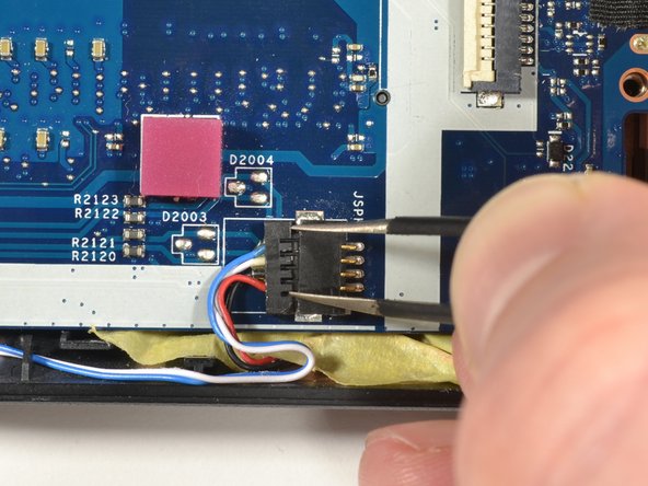

  26. Acer E5-571-54FL RAM Replacement: crwdns2935265:026crwdnd2935265:01crwdnd2935265:02crwdne2935265:0 Acer E5-571-54FL RAM Replacement: crwdns2935265:026crwdnd2935265:02crwdnd2935265:02crwdne2935265:0
    • Place the tips of the ESD safe pointed tweezers between the plug and the socket of the speaker connection.
    • Gently push left to disconnect the speaker plug.

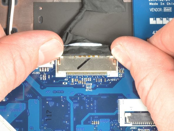

  27. Acer E5-571-54FL RAM Replacement: crwdns2935265:027crwdnd2935265:01crwdnd2935265:02crwdne2935265:0 Acer E5-571-54FL RAM Replacement: crwdns2935265:027crwdnd2935265:02crwdnd2935265:02crwdne2935265:0
    • Place your fingernails on each side of the screen connection plug. Gently push away from your body to disconnect the plug.

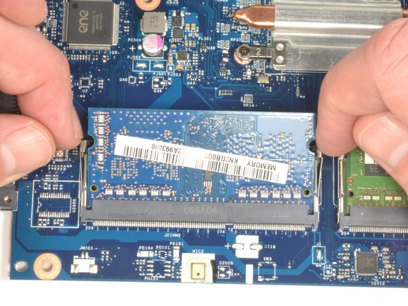

  32. Acer E5-571-54FL RAM Replacement: crwdns2935265:032crwdnd2935265:01crwdnd2935265:02crwdne2935265:0 Acer E5-571-54FL RAM Replacement: crwdns2935265:032crwdnd2935265:02crwdnd2935265:02crwdne2935265:0
    • There are two clips holding each RAM module into its respective connector.
    • Use your fingernails to gently pull each set of clips away from the RAM module at the same time.
    • When disengaged, the RAM module will pop up slightly.
    • Repeat this procedure for the remaining RAM module.
  33. Acer E5-571-54FL RAM Replacement: crwdns2935265:033crwdnd2935265:01crwdnd2935265:02crwdne2935265:0 Acer E5-571-54FL RAM Replacement: crwdns2935265:033crwdnd2935265:02crwdnd2935265:02crwdne2935265:0
    • Grip the upper left corner of the RAM module with your fingers.
    • Pull the module away from your body at a slight incline to remove it from the connector.
