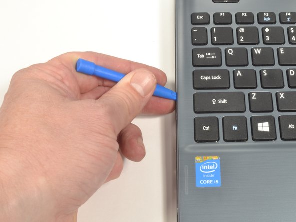

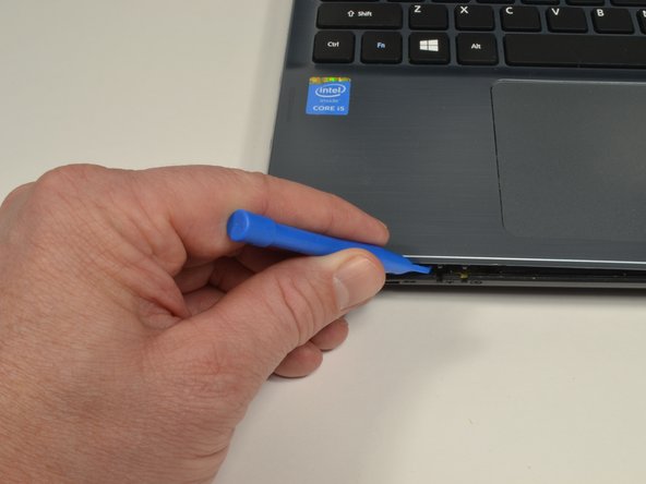

  8. Acer E5-571-54FL Keyboard Replacement: crwdns2935265:08crwdnd2935265:01crwdnd2935265:03crwdne2935265:0 Acer E5-571-54FL Keyboard Replacement: crwdns2935265:08crwdnd2935265:02crwdnd2935265:03crwdne2935265:0 Acer E5-571-54FL Keyboard Replacement: crwdns2935265:08crwdnd2935265:03crwdnd2935265:03crwdne2935265:0
    • Work your way around the seam with the plastic opening tool carefully prying the base and top cover apart.
    • If you have difficulty with the plastic opening tool, use a metal spudger but be more cautious to not damage or mar your laptop case.

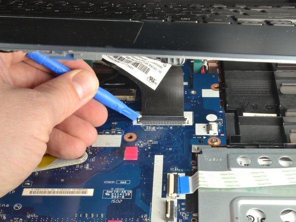

  10. Acer E5-571-54FL Keyboard Replacement: crwdns2935265:010crwdnd2935265:01crwdnd2935265:03crwdne2935265:0 Acer E5-571-54FL Keyboard Replacement: crwdns2935265:010crwdnd2935265:02crwdnd2935265:03crwdne2935265:0 Acer E5-571-54FL Keyboard Replacement: crwdns2935265:010crwdnd2935265:03crwdnd2935265:03crwdne2935265:0
    • Closest to the ribbon cable on the zero insertion force (ZIF) connector is a white locking tab.
    • Carefully lift up on the locking tab with the plastic opening tool to release the ribbon cable. (Picture 2)
    • Remove the ribbon cable from the connector.
  11. Acer E5-571-54FL Keyboard Replacement: crwdns2935265:011crwdnd2935265:01crwdnd2935265:03crwdne2935265:0 Acer E5-571-54FL Keyboard Replacement: crwdns2935265:011crwdnd2935265:02crwdnd2935265:03crwdne2935265:0 Acer E5-571-54FL Keyboard Replacement: crwdns2935265:011crwdnd2935265:03crwdnd2935265:03crwdne2935265:0
    • Closest to the ribbon cable on the ZIF connector is a black locking tab.

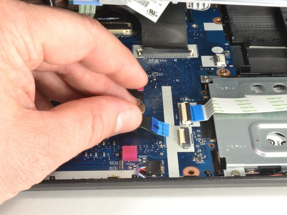

  12. Acer E5-571-54FL Keyboard Replacement: crwdns2935265:012crwdnd2935265:01crwdnd2935265:03crwdne2935265:0 Acer E5-571-54FL Keyboard Replacement: crwdns2935265:012crwdnd2935265:02crwdnd2935265:03crwdne2935265:0 Acer E5-571-54FL Keyboard Replacement: crwdns2935265:012crwdnd2935265:03crwdnd2935265:03crwdne2935265:0
    • On each side of the large connector there are two white tabs.
    • Carefully push away from you with the plastic opening tool on each white tab to release the cable. (Picture 2)
