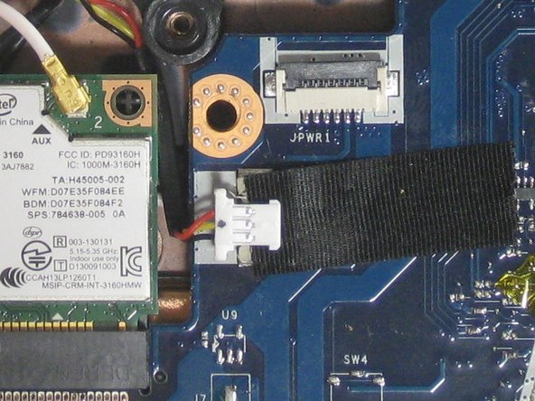

  14. Acer E5-571-54FL Cooling Fan Replacement, Cooling Fan: crwdns2935265:014crwdnd2935265:01crwdnd2935265:03crwdne2935265:0 Acer E5-571-54FL Cooling Fan Replacement, Cooling Fan: crwdns2935265:014crwdnd2935265:02crwdnd2935265:03crwdne2935265:0 Acer E5-571-54FL Cooling Fan Replacement, Cooling Fan: crwdns2935265:014crwdnd2935265:03crwdnd2935265:03crwdne2935265:0
    • Locate the CPU cooling fan in the upper left corner of the laptop.
    • Using a Phillips #0 screwdriver, remove the two 4.5 mm screws that secure the fan to the case.

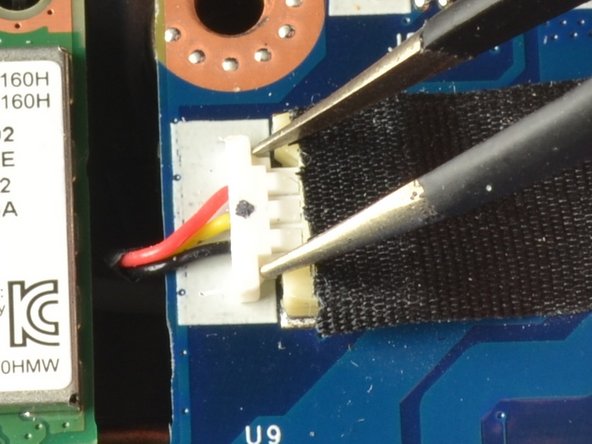

  15. Acer E5-571-54FL Cooling Fan Replacement: crwdns2935265:015crwdnd2935265:01crwdnd2935265:03crwdne2935265:0 Acer E5-571-54FL Cooling Fan Replacement: crwdns2935265:015crwdnd2935265:02crwdnd2935265:03crwdne2935265:0 Acer E5-571-54FL Cooling Fan Replacement: crwdns2935265:015crwdnd2935265:03crwdnd2935265:03crwdne2935265:0
    • Place the tips of the ESD safe pointed tweezers between the plug and the socket of the fan connection.
    • Gently push the tweezers to the left to disconnect the fan plug.
    • Move the fan connector and its wires to free them from the motherboard and the Wi-Fi card.
  16. Acer E5-571-54FL Cooling Fan Replacement: crwdns2935265:016crwdnd2935265:01crwdnd2935265:02crwdne2935265:0 Acer E5-571-54FL Cooling Fan Replacement: crwdns2935265:016crwdnd2935265:02crwdnd2935265:02crwdne2935265:0
    • Lift the curved end of the fan by about 30 degrees.
    • Use your hand to lift the fan up and to the right until it is clear of the case.
    • If you feel resistance, check if the fan connector and wires are stuck under the motherboard or under the Wi-Fi card. If the connector or wires are stuck, gently free them.
