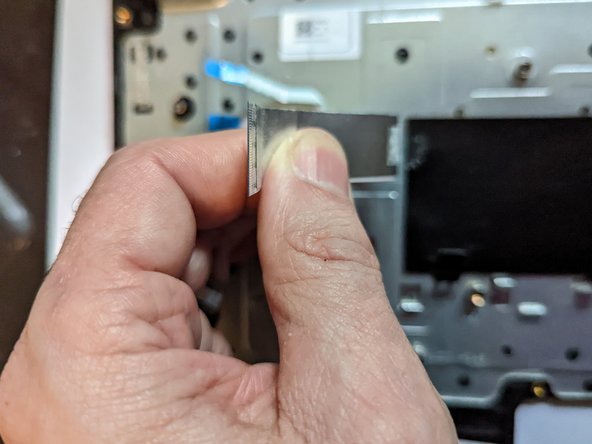

  13. Acer Chromebook cb3-532-c47c Keyboard / Palm Rest Replacement: crwdns2935265:013crwdnd2935265:01crwdnd2935265:02crwdne2935265:0 Acer Chromebook cb3-532-c47c Keyboard / Palm Rest Replacement: crwdns2935265:013crwdnd2935265:02crwdnd2935265:02crwdne2935265:0
    • Insert a screwdriver or spudger under the hinge to get it started then rotate it open by hand as far as possible.
  14. Acer Chromebook cb3-532-c47c Keyboard / Palm Rest Replacement, Remove the display assembly: crwdns2935265:014crwdnd2935265:01crwdnd2935265:03crwdne2935265:0 Acer Chromebook cb3-532-c47c Keyboard / Palm Rest Replacement, Remove the display assembly: crwdns2935265:014crwdnd2935265:02crwdnd2935265:03crwdne2935265:0 Acer Chromebook cb3-532-c47c Keyboard / Palm Rest Replacement, Remove the display assembly: crwdns2935265:014crwdnd2935265:03crwdnd2935265:03crwdne2935265:0
    • Lift the palm rest assembly from the front then slide it away from the hinges slightly to remove the assembly from the display.
  15. Acer Chromebook cb3-532-c47c Keyboard / Palm Rest Replacement, Touchpad: crwdns2935265:015crwdnd2935265:01crwdnd2935265:02crwdne2935265:0 Acer Chromebook cb3-532-c47c Keyboard / Palm Rest Replacement, Touchpad: crwdns2935265:015crwdnd2935265:02crwdnd2935265:02crwdne2935265:0
    • Flip up the retaining latch securing the touchpad cable to the motherboard.
  16. Acer Chromebook cb3-532-c47c Keyboard / Palm Rest Replacement: crwdns2935265:016crwdnd2935265:01crwdnd2935265:01crwdne2935265:0
    • Pull the ribbon from the motherboard laterally off the touchpad.
  17. Acer Chromebook cb3-532-c47c Keyboard / Palm Rest Replacement: crwdns2935265:017crwdnd2935265:01crwdnd2935265:01crwdne2935265:0
    • Using the Phillips #1 screwdriver, remove the three 3.2 mm screws holding the touchpad to the laptop.
  18. Acer Chromebook cb3-532-c47c Keyboard / Palm Rest Replacement: crwdns2935265:018crwdnd2935265:01crwdnd2935265:03crwdne2935265:0 Acer Chromebook cb3-532-c47c Keyboard / Palm Rest Replacement: crwdns2935265:018crwdnd2935265:02crwdnd2935265:03crwdne2935265:0 Acer Chromebook cb3-532-c47c Keyboard / Palm Rest Replacement: crwdns2935265:018crwdnd2935265:03crwdnd2935265:03crwdne2935265:0
    • Carefully lift up on the keyboard ribbon cable and the insulating sheet immediately below it so the touchpad can clear them.
    • Lift the touchpad slightly from the top.
    • Pull the touchpad toward the motherboard as you continue to lift it, sliding it out from under the retaining fingers at the bottom.
  19. Acer Chromebook cb3-532-c47c Keyboard / Palm Rest Replacement: crwdns2935265:019crwdnd2935265:01crwdnd2935265:03crwdne2935265:0 Acer Chromebook cb3-532-c47c Keyboard / Palm Rest Replacement: crwdns2935265:019crwdnd2935265:02crwdnd2935265:03crwdne2935265:0 Acer Chromebook cb3-532-c47c Keyboard / Palm Rest Replacement: crwdns2935265:019crwdnd2935265:03crwdnd2935265:03crwdne2935265:0
    • Remove the touchpad.
    • When reinstalling:
    • Make sure the touchpad goes underneath the two retaining fingers when reinstalling it.
    • The touchpad is correctly aligned when the guide pins next to the left and right screws are inserted in the holes.

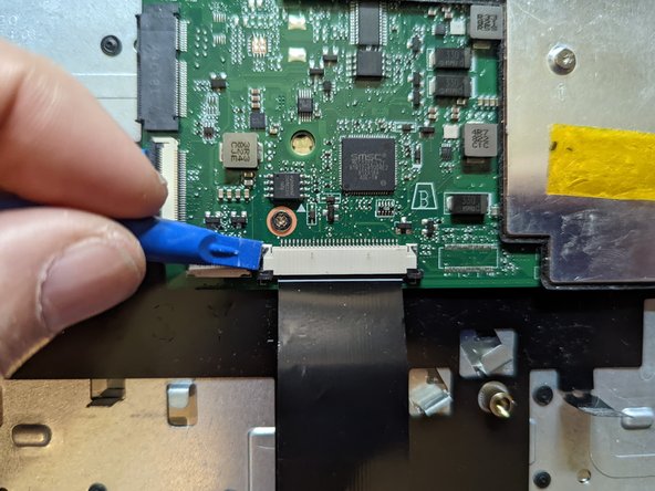

  24. Acer Chromebook cb3-532-c47c Keyboard / Palm Rest Replacement, Keyboard Cable: crwdns2935265:024crwdnd2935265:01crwdnd2935265:03crwdne2935265:0 Acer Chromebook cb3-532-c47c Keyboard / Palm Rest Replacement, Keyboard Cable: crwdns2935265:024crwdnd2935265:02crwdnd2935265:03crwdne2935265:0 Acer Chromebook cb3-532-c47c Keyboard / Palm Rest Replacement, Keyboard Cable: crwdns2935265:024crwdnd2935265:03crwdnd2935265:03crwdne2935265:0
    • Peel the yellow tape off the black keyboard ribbon cable on the motherboard.
    • Use a spudger to slide the black tabs on either side of the connector forward slightly.
    • Pull the black ribbon straight towards you to remove it from the motherboard.

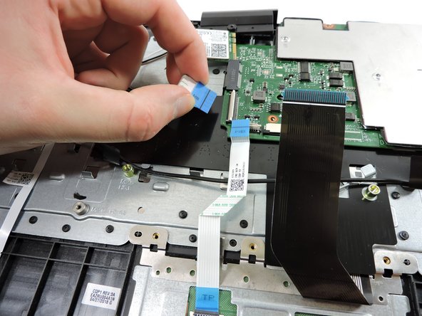

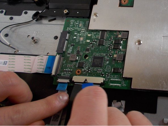

  25. Acer Chromebook cb3-532-c47c Keyboard / Palm Rest Replacement: crwdns2935265:025crwdnd2935265:01crwdnd2935265:03crwdne2935265:0 Acer Chromebook cb3-532-c47c Keyboard / Palm Rest Replacement: crwdns2935265:025crwdnd2935265:02crwdnd2935265:03crwdne2935265:0 Acer Chromebook cb3-532-c47c Keyboard / Palm Rest Replacement: crwdns2935265:025crwdnd2935265:03crwdnd2935265:03crwdne2935265:0
    • Flip up the tabs over the two white ribbons on the left using your finger.
    • For more information on Zero Insertion Force (ZIF) connectors, please visit this guide.
    • Pull the ribbons out of the motherboard by the blue tabs.

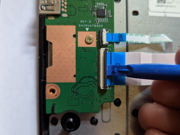

  28. Acer Chromebook cb3-532-c47c Keyboard / Palm Rest Replacement, Remove the LED Cable: crwdns2935265:028crwdnd2935265:01crwdnd2935265:02crwdne2935265:0 Acer Chromebook cb3-532-c47c Keyboard / Palm Rest Replacement, Remove the LED Cable: crwdns2935265:028crwdnd2935265:02crwdnd2935265:02crwdne2935265:0
    • Flip up the latch on the cable going from the I/O board to the LED board.
  29. Acer Chromebook cb3-532-c47c Keyboard / Palm Rest Replacement: crwdns2935265:029crwdnd2935265:01crwdnd2935265:02crwdne2935265:0 Acer Chromebook cb3-532-c47c Keyboard / Palm Rest Replacement: crwdns2935265:029crwdnd2935265:02crwdnd2935265:02crwdne2935265:0
    • Grasp the ribbon cable and pull it straight out to the right.
  30. Acer Chromebook cb3-532-c47c Keyboard / Palm Rest Replacement, Remove the Motherboard Cable: crwdns2935265:030crwdnd2935265:01crwdnd2935265:02crwdne2935265:0 Acer Chromebook cb3-532-c47c Keyboard / Palm Rest Replacement, Remove the Motherboard Cable: crwdns2935265:030crwdnd2935265:02crwdnd2935265:02crwdne2935265:0

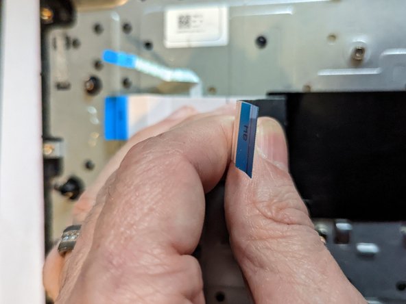

    • Flip up the latch on the cable from the I/O board to the motherboard.
  31. Acer Chromebook cb3-532-c47c Keyboard / Palm Rest Replacement: crwdns2935265:031crwdnd2935265:01crwdnd2935265:02crwdne2935265:0 Acer Chromebook cb3-532-c47c Keyboard / Palm Rest Replacement: crwdns2935265:031crwdnd2935265:02crwdnd2935265:02crwdne2935265:0
    • Grasp the ribbon cable by the blue plastic reinforcement and pull the cable straight out to the right.
  32. Acer Chromebook cb3-532-c47c Keyboard / Palm Rest Replacement, Remove the Retaining Screw: crwdns2935265:032crwdnd2935265:01crwdnd2935265:01crwdne2935265:0
    • Remove the single screw securing the I/O board.
  33. Acer Chromebook cb3-532-c47c Keyboard / Palm Rest Replacement: crwdns2935265:033crwdnd2935265:01crwdnd2935265:01crwdne2935265:0
    • Remove the I/O board.
    • When reinstalling, be sure the hinge goes above the I/O board, not below it.

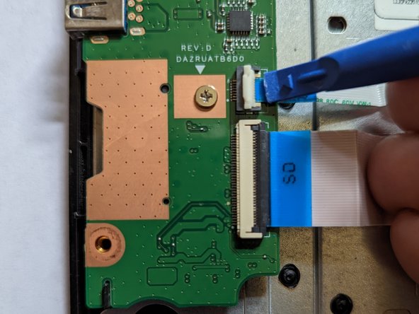

  34. Acer Chromebook cb3-532-c47c Keyboard / Palm Rest Replacement, Disconnect the LED board: crwdns2935265:034crwdnd2935265:01crwdnd2935265:02crwdne2935265:0 Acer Chromebook cb3-532-c47c Keyboard / Palm Rest Replacement, Disconnect the LED board: crwdns2935265:034crwdnd2935265:02crwdnd2935265:02crwdne2935265:0
    • Flip the retaining latch up with a spudger.
  35. Acer Chromebook cb3-532-c47c Keyboard / Palm Rest Replacement: crwdns2935265:035crwdnd2935265:01crwdnd2935265:02crwdne2935265:0 Acer Chromebook cb3-532-c47c Keyboard / Palm Rest Replacement: crwdns2935265:035crwdnd2935265:02crwdnd2935265:02crwdne2935265:0
    • Pull the cable straight out away from the front of the computer.
