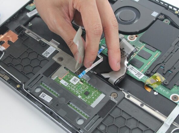

  5. Acer Chromebook Spin 714 CP714-2W-56B2 Trackpad Replacement, Trackpad: crwdns2935265:05crwdnd2935265:01crwdnd2935265:02crwdne2935265:0 Acer Chromebook Spin 714 CP714-2W-56B2 Trackpad Replacement, Trackpad: crwdns2935265:05crwdnd2935265:02crwdnd2935265:02crwdne2935265:0
    • Pull the blue ribbon by gently lifting up the flap to disconnect the trackpad from the motherboard.

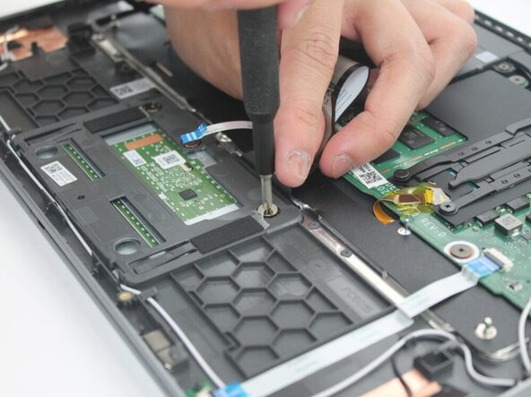

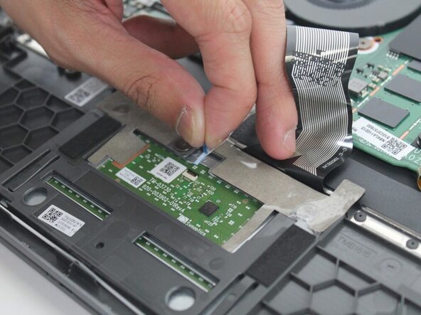

  6. Acer Chromebook Spin 714 CP714-2W-56B2 Trackpad Replacement: crwdns2935265:06crwdnd2935265:01crwdnd2935265:02crwdne2935265:0 Acer Chromebook Spin 714 CP714-2W-56B2 Trackpad Replacement: crwdns2935265:06crwdnd2935265:02crwdnd2935265:02crwdne2935265:0
    • Peel off the sticker that covers the screws locking the trackpad in place.
  7. Acer Chromebook Spin 714 CP714-2W-56B2 Trackpad Replacement: crwdns2935265:07crwdnd2935265:01crwdnd2935265:02crwdne2935265:0 Acer Chromebook Spin 714 CP714-2W-56B2 Trackpad Replacement: crwdns2935265:07crwdnd2935265:02crwdnd2935265:02crwdne2935265:0
    • Using the Phillips #00 screwdriver, remove the three 2 mm screws securing the trackpad to the frame.

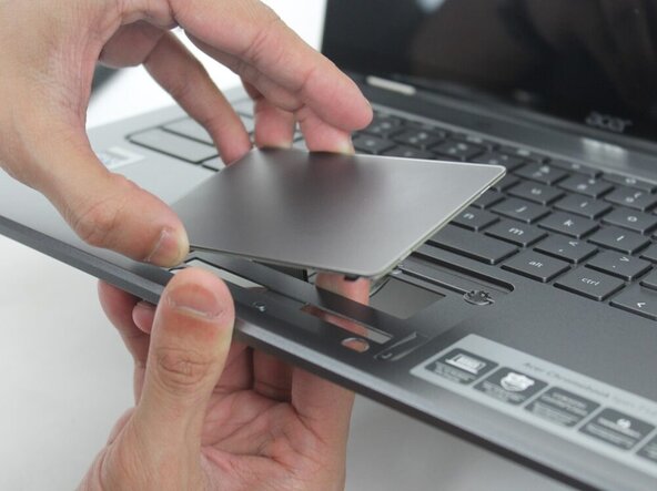

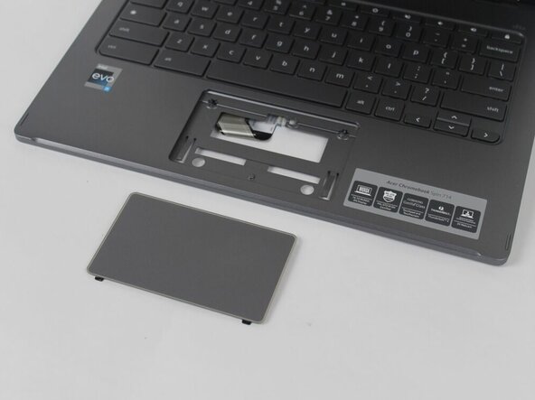

  8. Acer Chromebook Spin 714 CP714-2W-56B2 Trackpad Replacement: crwdns2935265:08crwdnd2935265:01crwdnd2935265:03crwdne2935265:0 Acer Chromebook Spin 714 CP714-2W-56B2 Trackpad Replacement: crwdns2935265:08crwdnd2935265:02crwdnd2935265:03crwdne2935265:0 Acer Chromebook Spin 714 CP714-2W-56B2 Trackpad Replacement: crwdns2935265:08crwdnd2935265:03crwdnd2935265:03crwdne2935265:0
    • From the internal side of the frame, gently apply upward pressure to the bottom side of the trackpad.
    • The trackpad will pop free from the palm rest opening as you push it outward.
    • Carefully lift the trackpad away from the laptop, noting its orientation for reinstallation.
