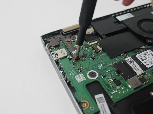

  5. Acer Chromebook Spin 714 CP714-2W-56B2 Hinges Replacement, Display Assembly: crwdns2935265:05crwdnd2935265:01crwdnd2935265:02crwdne2935265:0 Acer Chromebook Spin 714 CP714-2W-56B2 Hinges Replacement, Display Assembly: crwdns2935265:05crwdnd2935265:02crwdnd2935265:02crwdne2935265:0
    • Remove the three 4.6 mm screws holding the left-side screen bracket to the internal components using a JIS #1 screwdriver.
  6. Acer Chromebook Spin 714 CP714-2W-56B2 Hinges Replacement: crwdns2935265:06crwdnd2935265:01crwdnd2935265:01crwdne2935265:0
    • Flip the bracket away from its original location.

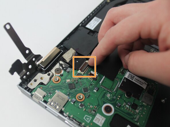

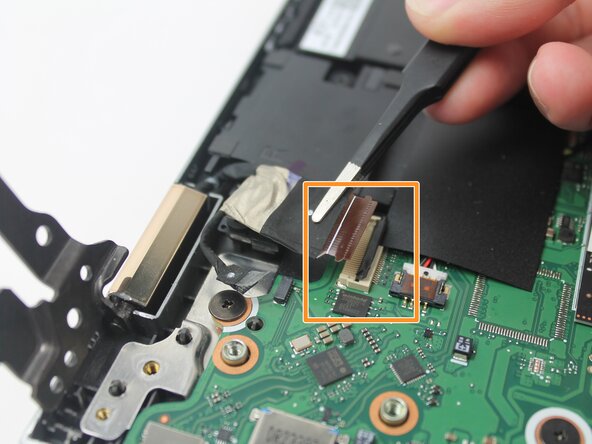

    • Remove the clear tape securing the smaller wire.
    • Flip the small black clip securing the larger wire.
    • The wire below loosely sits inside the plug. It is fine if it comes out on its own after the clip is opened.

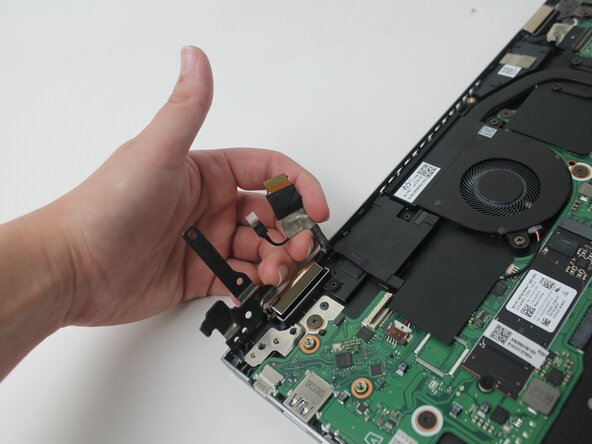

    • Unplug the smaller wire.
    • Lift the larger wire, if it is still in place.

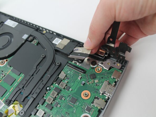

    • Remove the three 4.6 mm screws holding the right-side screen bracket to the internal components using a JIS #1 screwdriver.
    • Disconnect the ribbon cable from the motherboard.
    • There is only one wire on the right side. It's similar to the larger wire on the previous side, but slightly wider.

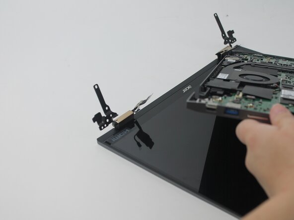

    • Remove the panel you've been working on.
    • Lift from the front edge of the panel, so that it and the screen form a 90 degree angle.
    • Pull the electrical panel straight back, away from the hinges/brackets. It shouldn't require any force.

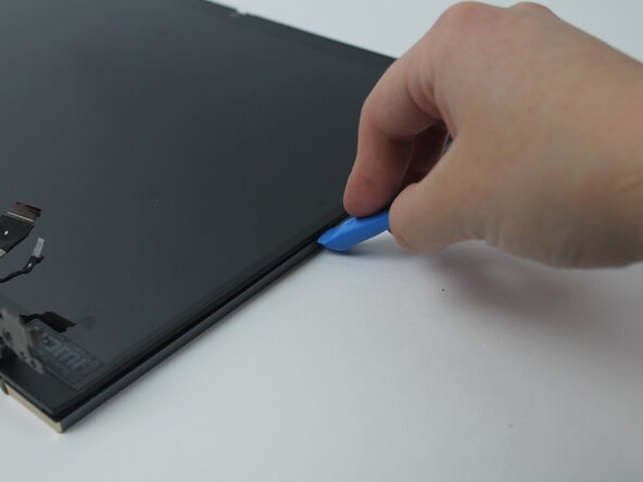

    • Separate the screen from the top casing using an opening tool.
  12. Acer Chromebook Spin 714 CP714-2W-56B2 Hinges Replacement: crwdns2935265:012crwdnd2935265:01crwdnd2935265:02crwdne2935265:0 Acer Chromebook Spin 714 CP714-2W-56B2 Hinges Replacement: crwdns2935265:012crwdnd2935265:02crwdnd2935265:02crwdne2935265:0

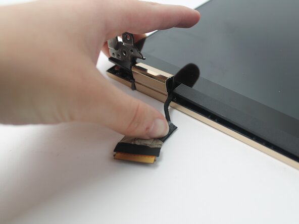

    • Untuck the wires next to hinges.
    • Lift the corner of the screen respective to the first hinge. Maneuver the wire around the edge of the screen on the other side of the hinge. Gently press the wire down onto your work surface.
  13. Acer Chromebook Spin 714 CP714-2W-56B2 Hinges Replacement: crwdns2935265:013crwdnd2935265:01crwdnd2935265:01crwdne2935265:0
    • Lift the screen from the hinge casing.
