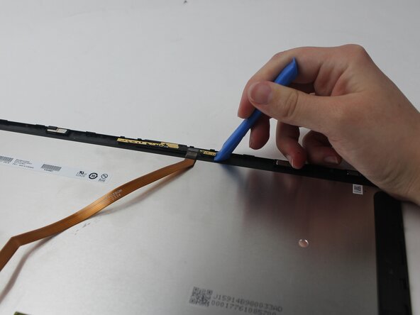

  14. Acer Chromebook Spin 714 CP714-2W-56B2 Camera Replacement, Camera: crwdns2935265:014crwdnd2935265:01crwdnd2935265:01crwdne2935265:0
    • Flip the screen over so that the silver panel is visible.
    • Note the silver wire at the bottom of the panel, as well as the ribbon running from the silver wire to the top part of the panel.
  15. Acer Chromebook Spin 714 CP714-2W-56B2 Camera Replacement: crwdns2935265:015crwdnd2935265:01crwdnd2935265:01crwdne2935265:0
    • Untuck the left side of the wire from the clip holding it in place.
  16. Acer Chromebook Spin 714 CP714-2W-56B2 Camera Replacement: crwdns2935265:016crwdnd2935265:01crwdnd2935265:03crwdne2935265:0 Acer Chromebook Spin 714 CP714-2W-56B2 Camera Replacement: crwdns2935265:016crwdnd2935265:02crwdnd2935265:03crwdne2935265:0 Acer Chromebook Spin 714 CP714-2W-56B2 Camera Replacement: crwdns2935265:016crwdnd2935265:03crwdnd2935265:03crwdne2935265:0
    • Remove the clear tape covering the plug.
    • Unplug the wire.
    • Unhook this side of the wire, like you did on the left side.

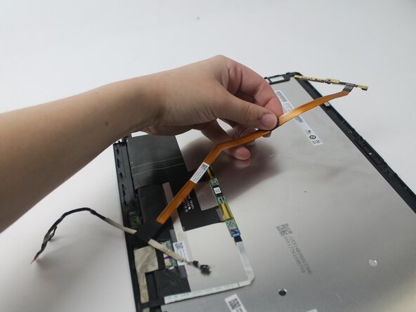

  17. Acer Chromebook Spin 714 CP714-2W-56B2 Camera Replacement: crwdns2935265:017crwdnd2935265:01crwdnd2935265:01crwdne2935265:0
    • Peel the orange ribbon from the silver panel.
  18. Acer Chromebook Spin 714 CP714-2W-56B2 Camera Replacement: crwdns2935265:018crwdnd2935265:01crwdnd2935265:02crwdne2935265:0 Acer Chromebook Spin 714 CP714-2W-56B2 Camera Replacement: crwdns2935265:018crwdnd2935265:02crwdnd2935265:02crwdne2935265:0

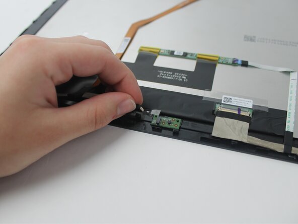

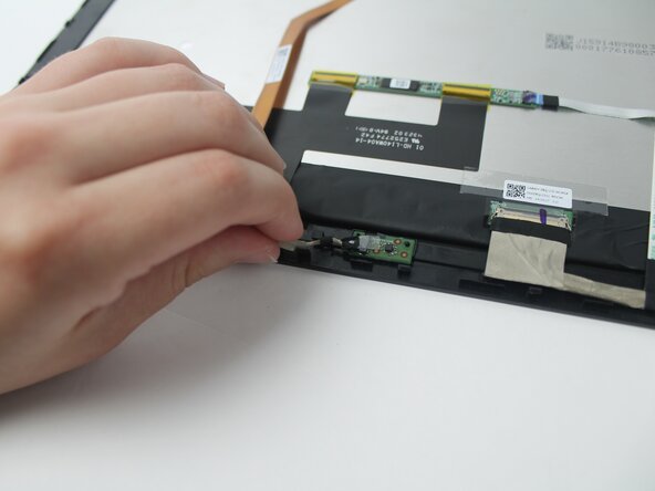

    • Remove both rubber pads on either side of the camera using an iFixit opening tool.
  19. Acer Chromebook Spin 714 CP714-2W-56B2 Camera Replacement: crwdns2935265:019crwdnd2935265:01crwdnd2935265:02crwdne2935265:0 Acer Chromebook Spin 714 CP714-2W-56B2 Camera Replacement: crwdns2935265:019crwdnd2935265:02crwdnd2935265:02crwdne2935265:0
    • Remove the camera from the screen.
