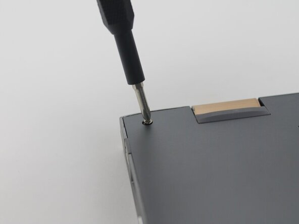

    • Flip the laptop to show the bottom side.
    • Remove the nine 6.5 mm screws using a JIS #1 screwdriver.

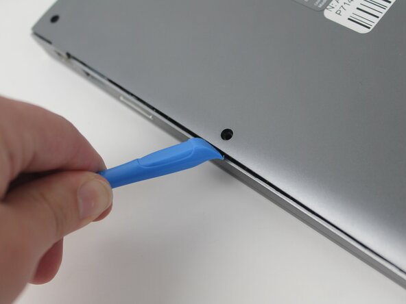

  2. Acer Chromebook Spin 714 CP714-2W-56B2 Battery Replacement: crwdns2935265:02crwdnd2935265:01crwdnd2935265:02crwdne2935265:0 Acer Chromebook Spin 714 CP714-2W-56B2 Battery Replacement: crwdns2935265:02crwdnd2935265:02crwdnd2935265:02crwdne2935265:0
    • Use a plastic opening tool to separate the outer casing and panel; gently work the tool around the entire outer edge
    • The easiest place to start is at one of the hinges. The corners can be somewhat difficult.
    • Be gentle. The internal clips can snap.

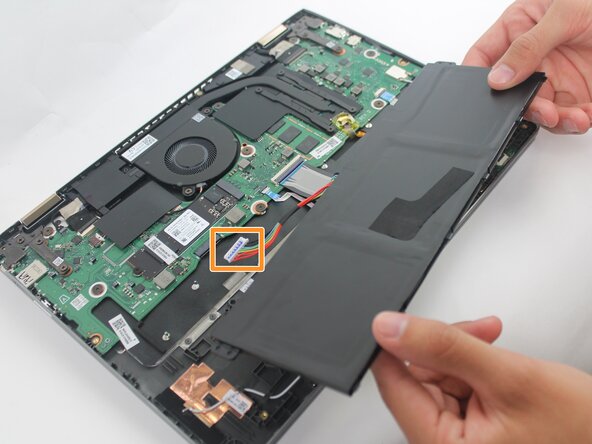

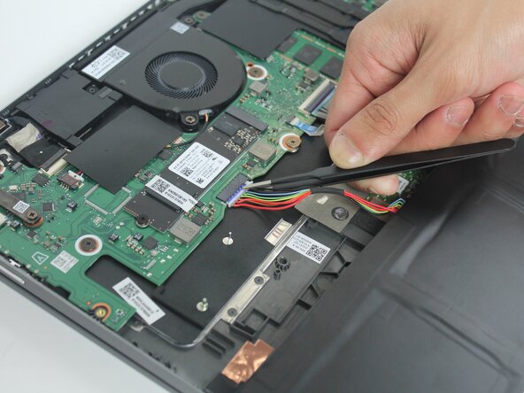

  4. Acer Chromebook Spin 714 CP714-2W-56B2 Battery Replacement: crwdns2935265:04crwdnd2935265:01crwdnd2935265:03crwdne2935265:0 Acer Chromebook Spin 714 CP714-2W-56B2 Battery Replacement: crwdns2935265:04crwdnd2935265:02crwdnd2935265:03crwdne2935265:0 Acer Chromebook Spin 714 CP714-2W-56B2 Battery Replacement: crwdns2935265:04crwdnd2935265:03crwdnd2935265:03crwdne2935265:0
    • Lift the battery from its studs, and place it closer to you.
    • The battery is not clamped or screwed onto the frame. Once you disconnect the battery, you are able to safely remove it by picking it up.
    • Unplug the rainbow wires connecting the battery to the motherboard.
    • Be sure to only grab the white portion of the plug, do not overstretch the rainbow wires.
    • Remove the battery from the laptop.
