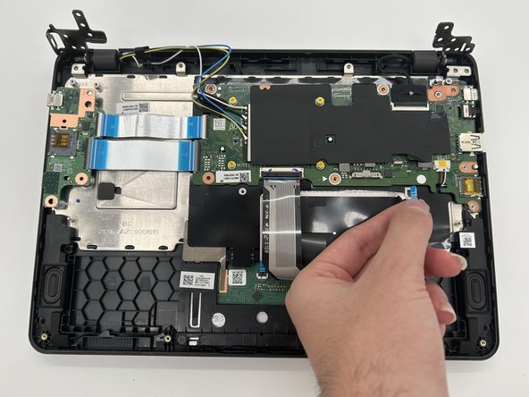

    • Detach the connector from the motherboard.
  7. Acer Chromebook Spin 511 (C741L) N20Q8 Motherboard Replacement: crwdns2935265:07crwdnd2935265:01crwdnd2935265:02crwdne2935265:0 Acer Chromebook Spin 511 (C741L) N20Q8 Motherboard Replacement: crwdns2935265:07crwdnd2935265:02crwdnd2935265:02crwdne2935265:0
    • Gently remove the blue, yellow, and black wires from their connectors.
  8. Acer Chromebook Spin 511 (C741L) N20Q8 Motherboard Replacement: crwdns2935265:08crwdnd2935265:01crwdnd2935265:02crwdne2935265:0 Acer Chromebook Spin 511 (C741L) N20Q8 Motherboard Replacement: crwdns2935265:08crwdnd2935265:02crwdnd2935265:02crwdne2935265:0
    • Remove the tape from the black connector and gently remove it from the socket.
  9. Acer Chromebook Spin 511 (C741L) N20Q8 Motherboard Replacement: crwdns2935265:09crwdnd2935265:01crwdnd2935265:02crwdne2935265:0 Acer Chromebook Spin 511 (C741L) N20Q8 Motherboard Replacement: crwdns2935265:09crwdnd2935265:02crwdnd2935265:02crwdne2935265:0
    • Carefully remove the pin connector containing the black, white, and red wires from its socket.
  10. Acer Chromebook Spin 511 (C741L) N20Q8 Motherboard Replacement: crwdns2935265:010crwdnd2935265:01crwdnd2935265:03crwdne2935265:0 Acer Chromebook Spin 511 (C741L) N20Q8 Motherboard Replacement: crwdns2935265:010crwdnd2935265:02crwdnd2935265:03crwdne2935265:0 Acer Chromebook Spin 511 (C741L) N20Q8 Motherboard Replacement: crwdns2935265:010crwdnd2935265:03crwdnd2935265:03crwdne2935265:0
    • Detach the long connector from the socket.
    • Remove the motherboard from the device.
