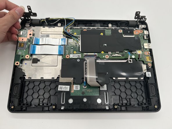

  4. Acer Chromebook Spin 511 (C741L) N20Q8 I/O Board Replacement, I/O Board: crwdns2935265:04crwdnd2935265:01crwdnd2935265:02crwdne2935265:0 Acer Chromebook Spin 511 (C741L) N20Q8 I/O Board Replacement, I/O Board: crwdns2935265:04crwdnd2935265:02crwdnd2935265:02crwdne2935265:0
    • Remove the four 2.4 mm screws from the hinge in the upper left corner using a Phillips #1 screwdriver.
    • Flip the gray hinges up.

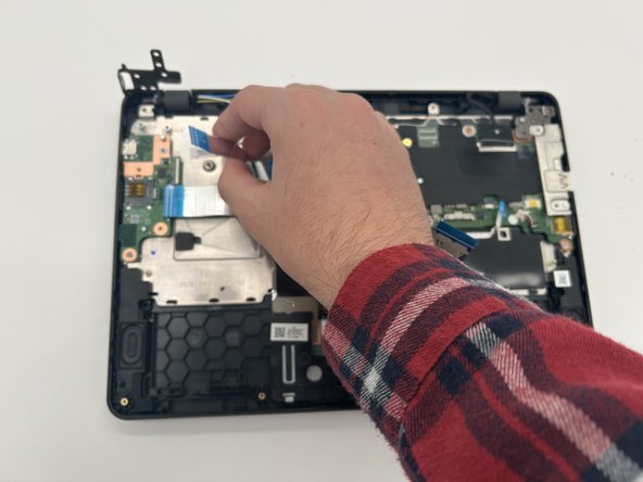

  5. Acer Chromebook Spin 511 (C741L) N20Q8 I/O Board Replacement: crwdns2935265:05crwdnd2935265:01crwdnd2935265:01crwdne2935265:0
    • Remove the metal plate above the I/O board.
  6. Acer Chromebook Spin 511 (C741L) N20Q8 I/O Board Replacement: crwdns2935265:06crwdnd2935265:01crwdnd2935265:02crwdne2935265:0 Acer Chromebook Spin 511 (C741L) N20Q8 I/O Board Replacement: crwdns2935265:06crwdnd2935265:02crwdnd2935265:02crwdne2935265:0
    • Detach the two connectors attached to the motherboard.
  7. Acer Chromebook Spin 511 (C741L) N20Q8 I/O Board Replacement: crwdns2935265:07crwdnd2935265:01crwdnd2935265:01crwdne2935265:0
    • Remove the I/O board from the laptop.
