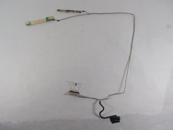

  6. Acer Chromebook Spin 15 CP315-1H-P1K8 Microphone Replacement, Microphone: crwdns2935265:06crwdnd2935265:01crwdnd2935265:01crwdne2935265:0
    • Remove the two 3 mm Phillips #1 black screws from the microphone at the top of the display cover.
  7. Acer Chromebook Spin 15 CP315-1H-P1K8 Microphone Replacement: crwdns2935265:07crwdnd2935265:01crwdnd2935265:02crwdne2935265:0 Acer Chromebook Spin 15 CP315-1H-P1K8 Microphone Replacement: crwdns2935265:07crwdnd2935265:02crwdnd2935265:02crwdne2935265:0
    • Remove the microphone component from the rest of the computer by detaching the connected wire.
    • The camera component of the laptop is connected to the same wire, so remove this as well.
    • The camera is only held down with adhesives, so there is no need to use any tools.
  8. Acer Chromebook Spin 15 CP315-1H-P1K8 Microphone Replacement: crwdns2935265:08crwdnd2935265:01crwdnd2935265:02crwdne2935265:0 Acer Chromebook Spin 15 CP315-1H-P1K8 Microphone Replacement: crwdns2935265:08crwdnd2935265:02crwdnd2935265:02crwdne2935265:0
    • Remove the microphone and camera wire out from around the display screen.
    • Remove the ribbon cable at the bottom of the display screen to completely free the wire.
    • Carefully remove the adhesive tape and take out the ribbon cable.
  9. Acer Chromebook Spin 15 CP315-1H-P1K8 Microphone Replacement: crwdns2935265:09crwdnd2935265:01crwdnd2935265:02crwdne2935265:0 Acer Chromebook Spin 15 CP315-1H-P1K8 Microphone Replacement: crwdns2935265:09crwdnd2935265:02crwdnd2935265:02crwdne2935265:0
    • Remove the microphone from the laptop.
