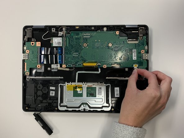

  5. Acer Chromebook Spin 11 R751TN-C5P3 Speakers Replacement, Speakers: crwdns2935265:05crwdnd2935265:01crwdnd2935265:02crwdne2935265:0 Acer Chromebook Spin 11 R751TN-C5P3 Speakers Replacement, Speakers: crwdns2935265:05crwdnd2935265:02crwdnd2935265:02crwdne2935265:0
    • The speakers are connected a small amount of adhesive tape. They can be pulled out by gripping them and gently wiggling them up and out.
    • Unplug the cord connecting the speaker to the motherboard by gripping it on the sides and pulling.
  6. Acer Chromebook Spin 11 R751TN-C5P3 Speakers Replacement: crwdns2935265:06crwdnd2935265:01crwdnd2935265:01crwdne2935265:0
    • Use a Phillips #0 screwdriver to remove the 3 mm screw that secures the trackpad. Lift the trackpad away to expose the cord connecting the two speakers.
  7. Acer Chromebook Spin 11 R751TN-C5P3 Speakers Replacement: crwdns2935265:07crwdnd2935265:01crwdnd2935265:01crwdne2935265:0
    • Pull the cord out from the hooks to remove it.
