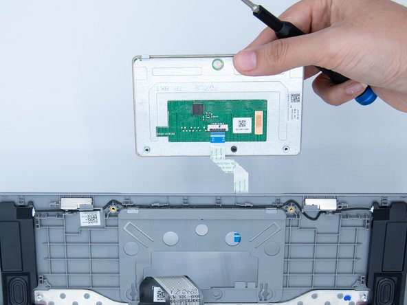

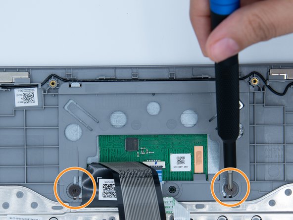

  3. Acer Chromebook R841T-S4ZG Touchpad Replacement: crwdns2935265:03crwdnd2935265:01crwdnd2935265:03crwdne2935265:0 Acer Chromebook R841T-S4ZG Touchpad Replacement: crwdns2935265:03crwdnd2935265:02crwdnd2935265:03crwdne2935265:0 Acer Chromebook R841T-S4ZG Touchpad Replacement: crwdns2935265:03crwdnd2935265:03crwdnd2935265:03crwdne2935265:0
    • Lift up the ribbon cord attaching the track pad to the motherboard
    • Unscrew the two screws holding the trackpad to the casing
    • Carefully lift the track pad out. It has small teeth that hook unto the casing. It is important to get those lined up and seated properly when putting back together
