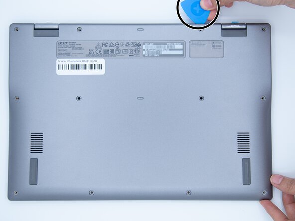

    • Unscrew the 8 back screws, circled in red. The screws in red are 4.90mm x 5.71mm.
    • The 4 blue screws on the bottom are 4.81mm x 4.6mm.
    • Using an opening pick, unclip the lips that are located around the edges of the device.
