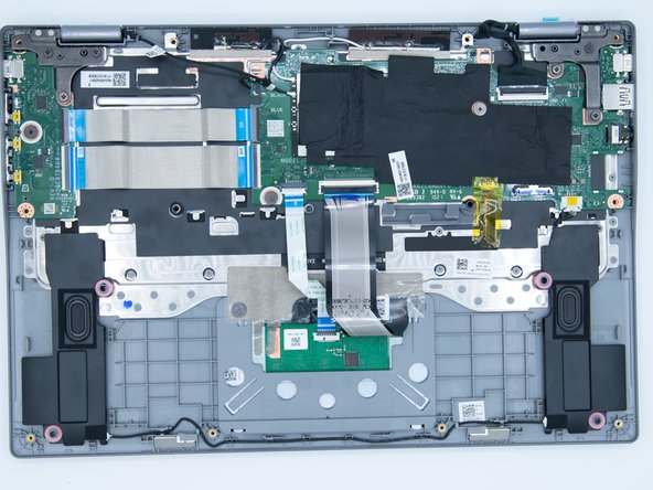

    • Unscrew the 12 back screws, circled in red. The top 8 screws are 4.90mm x 5.71mm.
    • The 4 blue screws on the bottom are 4.81mm x 4.6mm.
  2. Acer Chromebook R841T-S4ZG Battery Replacement: crwdns2935265:02crwdnd2935265:01crwdnd2935265:02crwdne2935265:0 Acer Chromebook R841T-S4ZG Battery Replacement: crwdns2935265:02crwdnd2935265:02crwdnd2935265:02crwdne2935265:0
    • Using an opening pick, unclip the lips that are located around the edges of the device.
  3. Acer Chromebook R841T-S4ZG Battery Replacement: crwdns2935265:03crwdnd2935265:01crwdnd2935265:03crwdne2935265:0 Acer Chromebook R841T-S4ZG Battery Replacement: crwdns2935265:03crwdnd2935265:02crwdnd2935265:03crwdne2935265:0 Acer Chromebook R841T-S4ZG Battery Replacement: crwdns2935265:03crwdnd2935265:03crwdnd2935265:03crwdne2935265:0

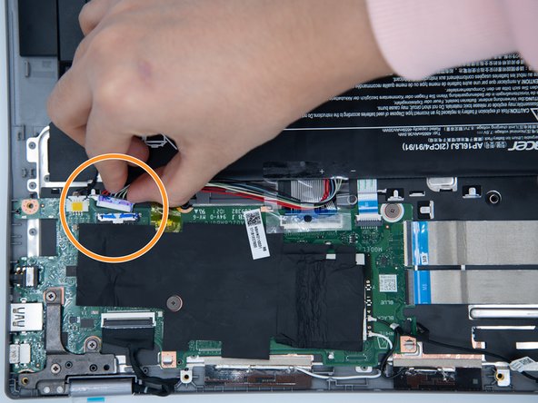

    • Looking at the inside of the device, locate the battery plug, and remove it.
    • The clip connector should pull out after a little bit of force is applied. But do not pull on the wires, pull on the white plastic part.
