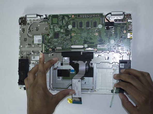

  5. Acer Chromebook R11 Speakers Replacement, Speakers: crwdns2935265:05crwdnd2935265:01crwdnd2935265:02crwdne2935265:0 Acer Chromebook R11 Speakers Replacement, Speakers: crwdns2935265:05crwdnd2935265:02crwdnd2935265:02crwdne2935265:0
    • Slide out black ribbons connecting speakers to motherboard
    • Connected on lower left-hand side of motherboard
    • When removing wires, remove gently with respect to metal clips along wires that are holding them in place.
    • Slide out white ribbon connecting keyboard to motherboard
  6. Acer Chromebook R11 Speakers Replacement: crwdns2935265:06crwdnd2935265:01crwdnd2935265:01crwdne2935265:0
    • Gently pull speakers upwards
    • Adhesive is below it
