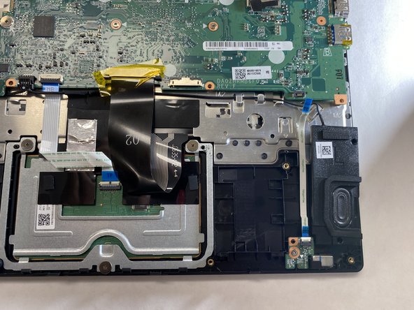

  5. Acer Chromebook R11 C738T-C44Z Speakers Replacement, Speakers: crwdns2935265:05crwdnd2935265:01crwdnd2935265:02crwdne2935265:0 Acer Chromebook R11 C738T-C44Z Speakers Replacement, Speakers: crwdns2935265:05crwdnd2935265:02crwdnd2935265:02crwdne2935265:0
    • Gently remove the LED Board Ribbon connected to the mother board.
  6. Acer Chromebook R11 C738T-C44Z Speakers Replacement: crwdns2935265:06crwdnd2935265:01crwdnd2935265:03crwdne2935265:0 Acer Chromebook R11 C738T-C44Z Speakers Replacement: crwdns2935265:06crwdnd2935265:02crwdnd2935265:03crwdne2935265:0 Acer Chromebook R11 C738T-C44Z Speakers Replacement: crwdns2935265:06crwdnd2935265:03crwdnd2935265:03crwdne2935265:0
    • Gently pry up speaker up using a spudger or opening tool to remove it.
    • It has an adhesive, so you might have to use some force.
    • Screwdrivers should not be used as prying tools and could cause damage to delicate components.
    • Repeat the same process for the other speaker.

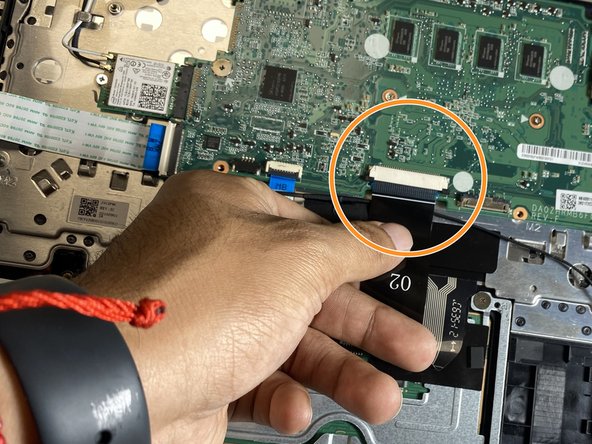

  7. Acer Chromebook R11 C738T-C44Z Speakers Replacement: crwdns2935265:07crwdnd2935265:01crwdnd2935265:03crwdne2935265:0 Acer Chromebook R11 C738T-C44Z Speakers Replacement: crwdns2935265:07crwdnd2935265:02crwdnd2935265:03crwdne2935265:0 Acer Chromebook R11 C738T-C44Z Speakers Replacement: crwdns2935265:07crwdnd2935265:03crwdnd2935265:03crwdne2935265:0
    • Use the opening tool to unplug the speaker cable from the motherboard.
    • Disconnect the keyboard ribbon cable from the motherboard.

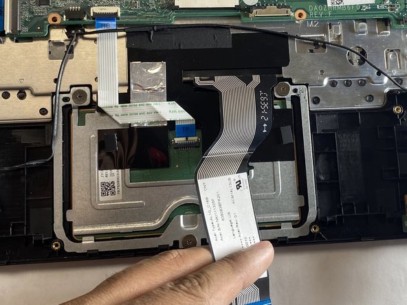

  8. Acer Chromebook R11 C738T-C44Z Speakers Replacement: crwdns2935265:08crwdnd2935265:01crwdnd2935265:01crwdne2935265:0
    • Using the opening tool to unlock and disconnect the touchpad cable.
  9. Acer Chromebook R11 C738T-C44Z Speakers Replacement: crwdns2935265:09crwdnd2935265:01crwdnd2935265:03crwdne2935265:0 Acer Chromebook R11 C738T-C44Z Speakers Replacement: crwdns2935265:09crwdnd2935265:02crwdnd2935265:03crwdne2935265:0 Acer Chromebook R11 C738T-C44Z Speakers Replacement: crwdns2935265:09crwdnd2935265:03crwdnd2935265:03crwdne2935265:0
    • Gently lift the speakers up and remove the cable from the system.
