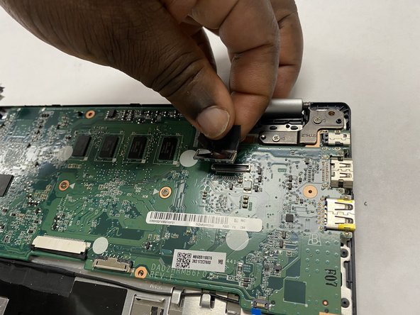

    • Disconnect the daughterboard ribbon by flipping up the white tab and pulling it out from the motherboard.
  11. Acer Chromebook R11 C738T-C44Z Motherboard Replacement: crwdns2935265:011crwdnd2935265:01crwdnd2935265:02crwdne2935265:0 Acer Chromebook R11 C738T-C44Z Motherboard Replacement: crwdns2935265:011crwdnd2935265:02crwdnd2935265:02crwdne2935265:0
    • Disconnect the touchpad ribbon by lifting up the tab and pulling it out.
  12. Acer Chromebook R11 C738T-C44Z Motherboard Replacement: crwdns2935265:012crwdnd2935265:01crwdnd2935265:02crwdne2935265:0 Acer Chromebook R11 C738T-C44Z Motherboard Replacement: crwdns2935265:012crwdnd2935265:02crwdnd2935265:02crwdne2935265:0
    • Disconnect the sensor cable by pulling it out.
  13. Acer Chromebook R11 C738T-C44Z Motherboard Replacement: crwdns2935265:013crwdnd2935265:01crwdnd2935265:03crwdne2935265:0 Acer Chromebook R11 C738T-C44Z Motherboard Replacement: crwdns2935265:013crwdnd2935265:02crwdnd2935265:03crwdne2935265:0 Acer Chromebook R11 C738T-C44Z Motherboard Replacement: crwdns2935265:013crwdnd2935265:03crwdnd2935265:03crwdne2935265:0

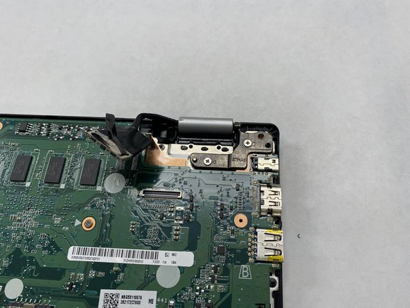

    • Disconnect the LCD cable by pinching it and lifting it off the motherboard.
  14. Acer Chromebook R11 C738T-C44Z Motherboard Replacement: crwdns2935265:014crwdnd2935265:01crwdnd2935265:02crwdne2935265:0 Acer Chromebook R11 C738T-C44Z Motherboard Replacement: crwdns2935265:014crwdnd2935265:02crwdnd2935265:02crwdne2935265:0
    • Use a Phillips #1 screwdriver to remove the two 3 mm screws that hold the hinge down.
  15. Acer Chromebook R11 C738T-C44Z Motherboard Replacement: crwdns2935265:015crwdnd2935265:01crwdnd2935265:03crwdne2935265:0 Acer Chromebook R11 C738T-C44Z Motherboard Replacement: crwdns2935265:015crwdnd2935265:02crwdnd2935265:03crwdne2935265:0 Acer Chromebook R11 C738T-C44Z Motherboard Replacement: crwdns2935265:015crwdnd2935265:03crwdnd2935265:03crwdne2935265:0
    • Use a Phillips #1 screwdriver to remove the three 3 mm screws that secure the motherboard.
  16. Acer Chromebook R11 C738T-C44Z Motherboard Replacement: crwdns2935265:016crwdnd2935265:01crwdnd2935265:02crwdne2935265:0 Acer Chromebook R11 C738T-C44Z Motherboard Replacement: crwdns2935265:016crwdnd2935265:02crwdnd2935265:02crwdne2935265:0
    • Slide the opening tool underneath the hinge latch to lift it up.
    • This is to free the motherboard.
  17. Acer Chromebook R11 C738T-C44Z Motherboard Replacement: crwdns2935265:017crwdnd2935265:01crwdnd2935265:02crwdne2935265:0 Acer Chromebook R11 C738T-C44Z Motherboard Replacement: crwdns2935265:017crwdnd2935265:02crwdnd2935265:02crwdne2935265:0
    • Grab the motherboard securely to lift and remove it.
