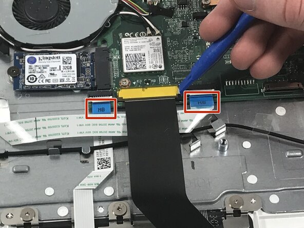

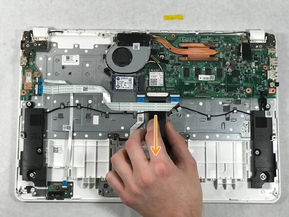

    • Use the plastic pry tool to unlatch the two tabs on either side of the black ribbon.
    • Gently slide the black ribbon out from its socket and under the white ribbon.
  7. Acer Chromebook CB5-571-C5XU Speaker Replacement: crwdns2935265:07crwdnd2935265:01crwdnd2935265:01crwdne2935265:0
    • Carefully remove the smaller black ribbon from the motherboard using the opening tool.
    • Be careful when prying the connector loose, its small size can make it difficult to grasp a corner of the connector.
  8. Acer Chromebook CB5-571-C5XU Speaker Replacement: crwdns2935265:08crwdnd2935265:01crwdnd2935265:01crwdne2935265:0
    • Weave the black wire connecting the two speakers out of the small metal hooks.
    • It might be helpful to take a picture of how the wire is wrapped around the hooks, as this layout is important when the wire is put back.
  9. Acer Chromebook CB5-571-C5XU Speaker Replacement: crwdns2935265:09crwdnd2935265:01crwdnd2935265:01crwdne2935265:0
    • Simply lift upwards on both speakers, and they will remove from their position.
