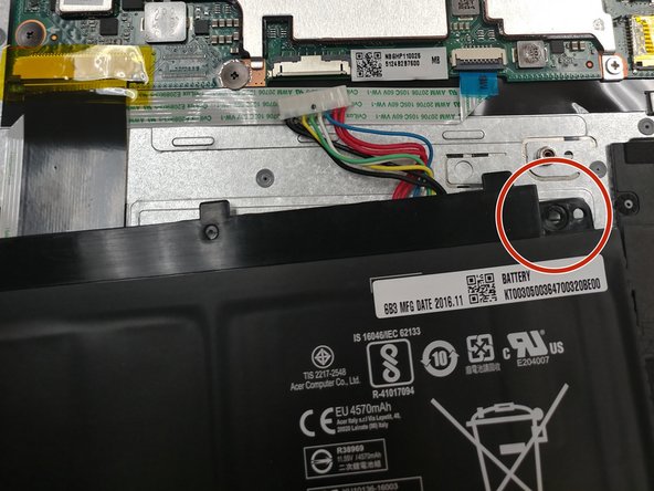

  3. Acer Chromebook CB5-312T-K 8Z9 Speaker Replacement, Battery: crwdns2935265:03crwdnd2935265:01crwdnd2935265:03crwdne2935265:0 Acer Chromebook CB5-312T-K 8Z9 Speaker Replacement, Battery: crwdns2935265:03crwdnd2935265:02crwdnd2935265:03crwdne2935265:0 Acer Chromebook CB5-312T-K 8Z9 Speaker Replacement, Battery: crwdns2935265:03crwdnd2935265:03crwdnd2935265:03crwdne2935265:0
    • look for the battery in the bottom half of the computer
    • Once you have found the battery, look for the screws that secure the battery, in the upper left and right corners.
  4. Acer Chromebook CB5-312T-K 8Z9 Speaker Replacement: crwdns2935265:04crwdnd2935265:01crwdnd2935265:03crwdne2935265:0 Acer Chromebook CB5-312T-K 8Z9 Speaker Replacement: crwdns2935265:04crwdnd2935265:02crwdnd2935265:03crwdne2935265:0 Acer Chromebook CB5-312T-K 8Z9 Speaker Replacement: crwdns2935265:04crwdnd2935265:03crwdnd2935265:03crwdne2935265:0
    • Begin by unscrewing the two Phillips head screws that hold down the battery using a J1 sized screwdriver.
    • Finally remove the battery from the laptop.

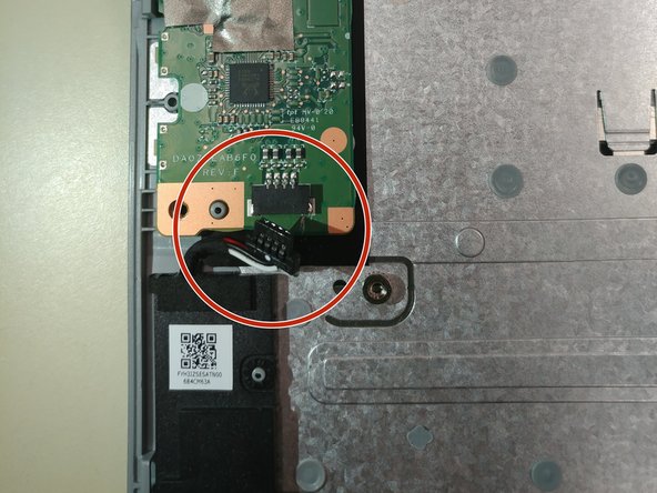

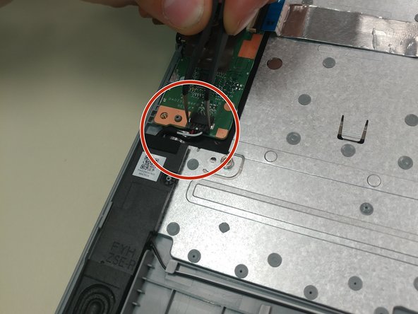

  5. Acer Chromebook CB5-312T-K 8Z9 Speaker Replacement, Speaker: crwdns2935265:05crwdnd2935265:01crwdnd2935265:03crwdne2935265:0 Acer Chromebook CB5-312T-K 8Z9 Speaker Replacement, Speaker: crwdns2935265:05crwdnd2935265:02crwdnd2935265:03crwdne2935265:0 Acer Chromebook CB5-312T-K 8Z9 Speaker Replacement, Speaker: crwdns2935265:05crwdnd2935265:03crwdnd2935265:03crwdne2935265:0
    • Begin by locating the speakers.
    • Once you have found where the speakers are, direct your attention to the speaker to the left of the mouse pad.
    • Grab your tweezers and begin disconnecting the wire that connects the speakers to the circuit board on the upper left corner.

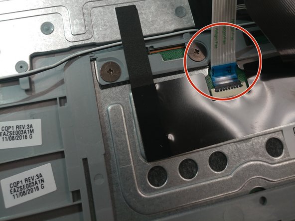

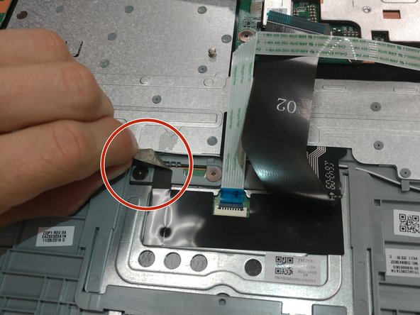

  6. Acer Chromebook CB5-312T-K 8Z9 Speaker Replacement: crwdns2935265:06crwdnd2935265:01crwdnd2935265:03crwdne2935265:0 Acer Chromebook CB5-312T-K 8Z9 Speaker Replacement: crwdns2935265:06crwdnd2935265:02crwdnd2935265:03crwdne2935265:0 Acer Chromebook CB5-312T-K 8Z9 Speaker Replacement: crwdns2935265:06crwdnd2935265:03crwdnd2935265:03crwdne2935265:0
    • Locate where the mouse pad would be, this should be relatively easy as it will be right in between the two speakers.
    • Start peeling off the black tape that is covering the speaker wires.
    • Fold back the cables that are on top of the wires for easy removal of the speakers.
