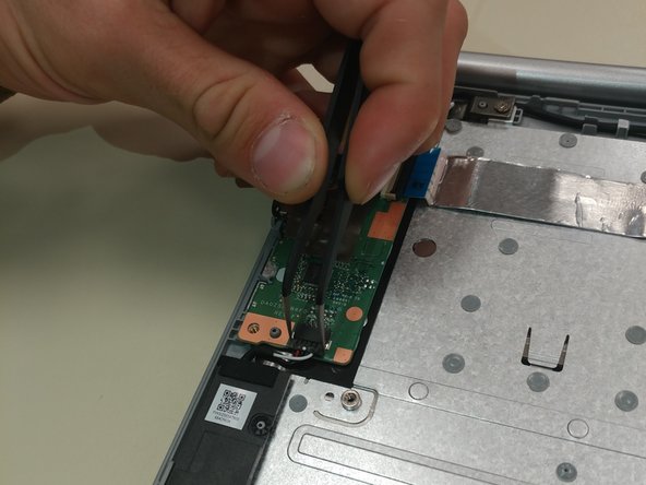

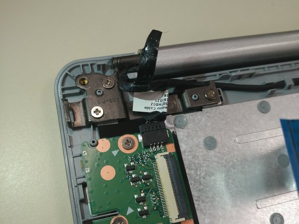

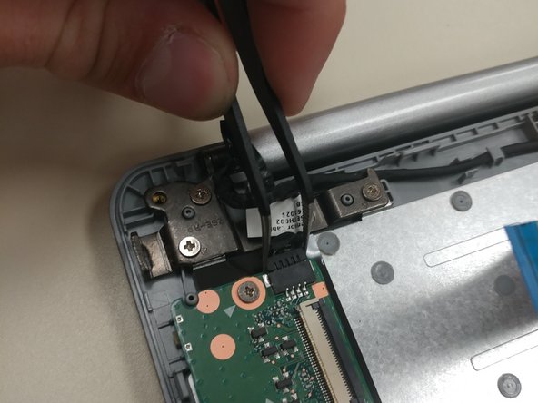

    • Identify the port that is connected to the speaker.
    • Using tweezers, separate the cable from the port.

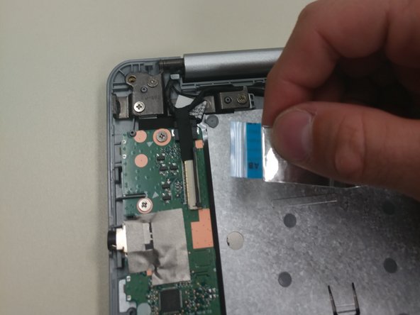

    • Find and remove the blue tape from the circuit board.
  5. Acer Chromebook CB5-312T-K 8Z9 Secondary Circuit Board  Replacement: crwdns2935265:05crwdnd2935265:01crwdnd2935265:03crwdne2935265:0 Acer Chromebook CB5-312T-K 8Z9 Secondary Circuit Board  Replacement: crwdns2935265:05crwdnd2935265:02crwdnd2935265:03crwdne2935265:0 Acer Chromebook CB5-312T-K 8Z9 Secondary Circuit Board  Replacement: crwdns2935265:05crwdnd2935265:03crwdnd2935265:03crwdne2935265:0
    • Remove the black tape from the port.

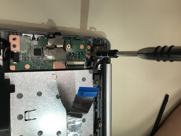

  6. Acer Chromebook CB5-312T-K 8Z9 Secondary Circuit Board  Replacement: crwdns2935265:06crwdnd2935265:01crwdnd2935265:03crwdne2935265:0 Acer Chromebook CB5-312T-K 8Z9 Secondary Circuit Board  Replacement: crwdns2935265:06crwdnd2935265:02crwdnd2935265:03crwdne2935265:0 Acer Chromebook CB5-312T-K 8Z9 Secondary Circuit Board  Replacement: crwdns2935265:06crwdnd2935265:03crwdnd2935265:03crwdne2935265:0

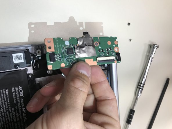

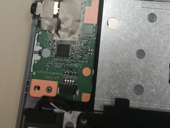

    • Identify the two Phillips screws.
    • Remove the two screws holding down the board with a J1 Phillips screwdriver.
    • Gently lift the board from the Chromebook.
