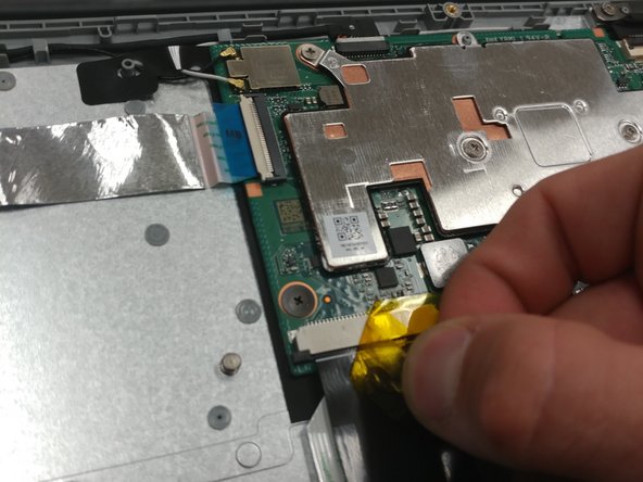

  5. Acer Chromebook CB5-312T-K 8Z9 Motherboard Replacement, Motherboard: crwdns2935265:05crwdnd2935265:01crwdnd2935265:03crwdne2935265:0 Acer Chromebook CB5-312T-K 8Z9 Motherboard Replacement, Motherboard: crwdns2935265:05crwdnd2935265:02crwdnd2935265:03crwdne2935265:0 Acer Chromebook CB5-312T-K 8Z9 Motherboard Replacement, Motherboard: crwdns2935265:05crwdnd2935265:03crwdnd2935265:03crwdne2935265:0
    • Remove the yellow tape covering the ribbon cable in the bottom left of the motherboard as shown.
    • Carefully remove the ribbon cable out from the connector.

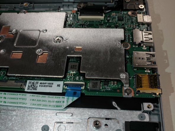

  6. Acer Chromebook CB5-312T-K 8Z9 Motherboard Replacement: crwdns2935265:06crwdnd2935265:01crwdnd2935265:03crwdne2935265:0 Acer Chromebook CB5-312T-K 8Z9 Motherboard Replacement: crwdns2935265:06crwdnd2935265:02crwdnd2935265:03crwdne2935265:0 Acer Chromebook CB5-312T-K 8Z9 Motherboard Replacement: crwdns2935265:06crwdnd2935265:03crwdnd2935265:03crwdne2935265:0
    • Fold up the grey cover to release the ribbon cable in the bottom right of the board as shown.
    • Carefully pull out the ribbon cable from the port by the blue tape.

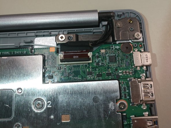

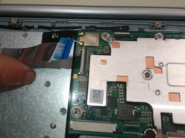

  7. Acer Chromebook CB5-312T-K 8Z9 Motherboard Replacement: crwdns2935265:07crwdnd2935265:01crwdnd2935265:03crwdne2935265:0 Acer Chromebook CB5-312T-K 8Z9 Motherboard Replacement: crwdns2935265:07crwdnd2935265:02crwdnd2935265:03crwdne2935265:0 Acer Chromebook CB5-312T-K 8Z9 Motherboard Replacement: crwdns2935265:07crwdnd2935265:03crwdnd2935265:03crwdne2935265:0
    • Fold up the white cover to release the ribbon cable in the top left of the board as shown.

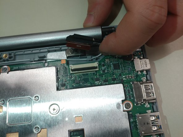

  8. Acer Chromebook CB5-312T-K 8Z9 Motherboard Replacement: crwdns2935265:08crwdnd2935265:01crwdnd2935265:03crwdne2935265:0 Acer Chromebook CB5-312T-K 8Z9 Motherboard Replacement: crwdns2935265:08crwdnd2935265:02crwdnd2935265:03crwdne2935265:0 Acer Chromebook CB5-312T-K 8Z9 Motherboard Replacement: crwdns2935265:08crwdnd2935265:03crwdnd2935265:03crwdne2935265:0
    • Fold up the grey cover to release the cable on the top right of the board as shown
    • Carefully pull out the cable from the port.

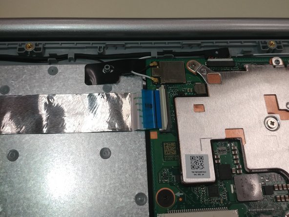

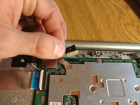

  9. Acer Chromebook CB5-312T-K 8Z9 Motherboard Replacement: crwdns2935265:09crwdnd2935265:01crwdnd2935265:02crwdne2935265:0 Acer Chromebook CB5-312T-K 8Z9 Motherboard Replacement: crwdns2935265:09crwdnd2935265:02crwdnd2935265:02crwdne2935265:0
    • Remove the cable with tweezers as shown along the top of the board.

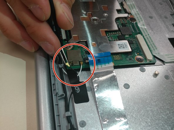

  10. Acer Chromebook CB5-312T-K 8Z9 Motherboard Replacement: crwdns2935265:010crwdnd2935265:01crwdnd2935265:02crwdne2935265:0 Acer Chromebook CB5-312T-K 8Z9 Motherboard Replacement: crwdns2935265:010crwdnd2935265:02crwdnd2935265:02crwdne2935265:0

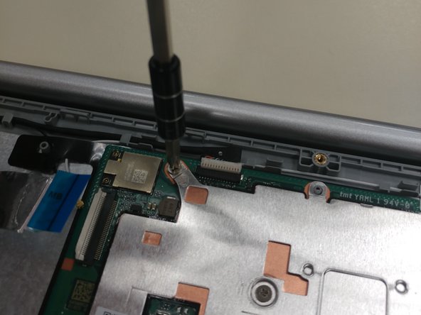

    • Carefully pull off both brass connectors from the top left of the board with tweezers as shown.

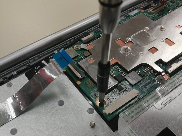

  11. Acer Chromebook CB5-312T-K 8Z9 Motherboard Replacement: crwdns2935265:011crwdnd2935265:01crwdnd2935265:03crwdne2935265:0 Acer Chromebook CB5-312T-K 8Z9 Motherboard Replacement: crwdns2935265:011crwdnd2935265:02crwdnd2935265:03crwdne2935265:0 Acer Chromebook CB5-312T-K 8Z9 Motherboard Replacement: crwdns2935265:011crwdnd2935265:03crwdnd2935265:03crwdne2935265:0
    • Remove the six screws from the board as shown. There are two types of screws here, so be careful to keep them separate for reassembly.

thanks for the write up! do you know where the bluetooth is on the motherboard? I presume step 10 are the connections to the wifi antennae?
leerandmcnally - crwdns2934203:0crwdne2934203:0
This Chromebook likely uses a dual chip which can be seen in step 10. I’m guessing the chip is a 802.11AC 2x2 MIMO WLAN + Bluetooth 4.0 from looking at the specs.
