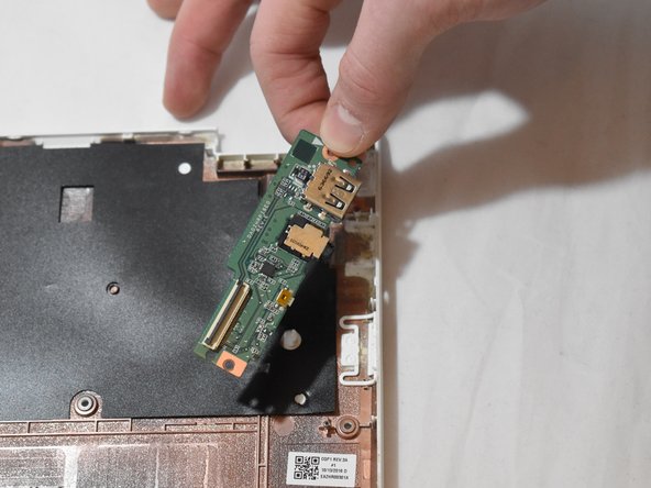

  5. Acer Chromebook CB5-132T-C8ZW USB Port Replacement, USB Port: crwdns2935265:05crwdnd2935265:01crwdnd2935265:02crwdne2935265:0 Acer Chromebook CB5-132T-C8ZW USB Port Replacement, USB Port: crwdns2935265:05crwdnd2935265:02crwdnd2935265:02crwdne2935265:0
    • From the back panel, remove one 3.4 mm JIS #1 screw.
  6. Acer Chromebook CB5-132T-C8ZW USB Port Replacement: crwdns2935265:06crwdnd2935265:01crwdnd2935265:02crwdne2935265:0 Acer Chromebook CB5-132T-C8ZW USB Port Replacement: crwdns2935265:06crwdnd2935265:02crwdnd2935265:02crwdne2935265:0
    • Remove the white connector strip using your fingers.
  7. Acer Chromebook CB5-132T-C8ZW USB Port Replacement: crwdns2935265:07crwdnd2935265:01crwdnd2935265:02crwdne2935265:0 Acer Chromebook CB5-132T-C8ZW USB Port Replacement: crwdns2935265:07crwdnd2935265:02crwdnd2935265:02crwdne2935265:0
    • Lift the USB port up using a spudger.
    • Remove the USB port with your fingers.
