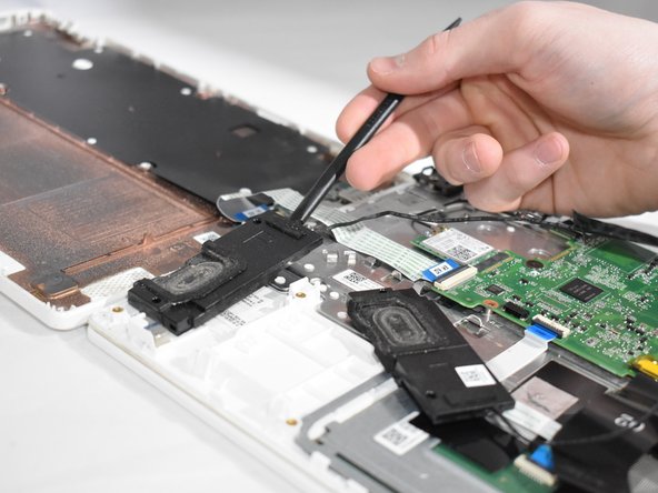

  5. Acer Chromebook CB5-132T-C8ZW Speakers Replacement, Speakers: crwdns2935265:05crwdnd2935265:01crwdnd2935265:03crwdne2935265:0 Acer Chromebook CB5-132T-C8ZW Speakers Replacement, Speakers: crwdns2935265:05crwdnd2935265:02crwdnd2935265:03crwdne2935265:0 Acer Chromebook CB5-132T-C8ZW Speakers Replacement, Speakers: crwdns2935265:05crwdnd2935265:03crwdnd2935265:03crwdne2935265:0
    • Lift the speakers up using a spudger.
  6. Acer Chromebook CB5-132T-C8ZW Speakers Replacement: crwdns2935265:06crwdnd2935265:01crwdnd2935265:01crwdne2935265:0
    • Lift the white strip up and slide the speaker underneath.

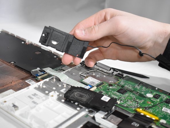

  7. Acer Chromebook CB5-132T-C8ZW Speakers Replacement: crwdns2935265:07crwdnd2935265:01crwdnd2935265:02crwdne2935265:0 Acer Chromebook CB5-132T-C8ZW Speakers Replacement: crwdns2935265:07crwdnd2935265:02crwdnd2935265:02crwdne2935265:0
    • Slide the speaker through the black power strip.
    • A plastic spudger may be helpful to hold the power strip up.
  8. Acer Chromebook CB5-132T-C8ZW Speakers Replacement: crwdns2935265:08crwdnd2935265:01crwdnd2935265:03crwdne2935265:0 Acer Chromebook CB5-132T-C8ZW Speakers Replacement: crwdns2935265:08crwdnd2935265:02crwdnd2935265:03crwdne2935265:0 Acer Chromebook CB5-132T-C8ZW Speakers Replacement: crwdns2935265:08crwdnd2935265:03crwdnd2935265:03crwdne2935265:0
    • Remove the black tape that holds the wire in place using precision tweezers.
    • Unhook the wire from the small hooks that hold the wire in place.

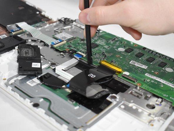

  9. Acer Chromebook CB5-132T-C8ZW Speakers Replacement: crwdns2935265:09crwdnd2935265:01crwdnd2935265:03crwdne2935265:0 Acer Chromebook CB5-132T-C8ZW Speakers Replacement: crwdns2935265:09crwdnd2935265:02crwdnd2935265:03crwdne2935265:0 Acer Chromebook CB5-132T-C8ZW Speakers Replacement: crwdns2935265:09crwdnd2935265:03crwdnd2935265:03crwdne2935265:0
    • Disconnect the black connective piece using tweezers.
    • Lift the second speaker up using a plastic spudger tool.
