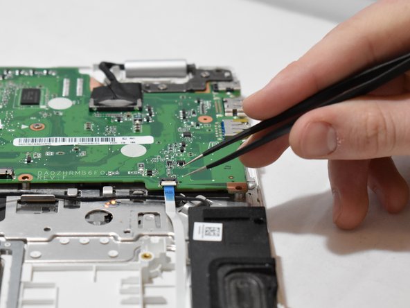

    • Carefully pull out the ribbon cable attached to the motherboard that runs wires to the battery.
    • Remove the battery.
  5. Acer Chromebook CB5-132T-C8ZW Motherboard Replacement, Motherboard: crwdns2935265:05crwdnd2935265:01crwdnd2935265:03crwdne2935265:0 Acer Chromebook CB5-132T-C8ZW Motherboard Replacement, Motherboard: crwdns2935265:05crwdnd2935265:02crwdnd2935265:03crwdne2935265:0 Acer Chromebook CB5-132T-C8ZW Motherboard Replacement, Motherboard: crwdns2935265:05crwdnd2935265:03crwdnd2935265:03crwdne2935265:0
    • Remove the six tabs connected to the motherboard.
    • Flip up the white tabs on the connectors, and pull out blue connective strips.
    • Pull up on the black connector on top right corner of the motherboard.

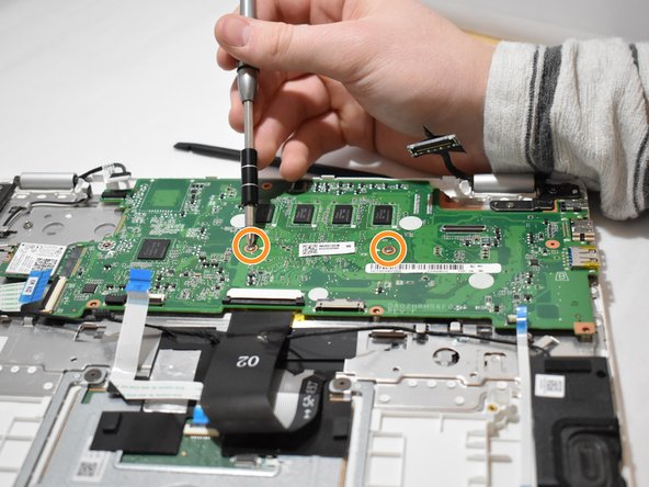

  6. Acer Chromebook CB5-132T-C8ZW Motherboard Replacement: crwdns2935265:06crwdnd2935265:01crwdnd2935265:02crwdne2935265:0 Acer Chromebook CB5-132T-C8ZW Motherboard Replacement: crwdns2935265:06crwdnd2935265:02crwdnd2935265:02crwdne2935265:0
    • Remove one 2.8mm JIS #1 screw from one end of the motherboard.
    • Remove two 2.2mm JIS #1 screws from the middle of the motherboard.

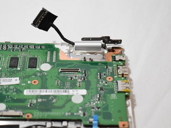

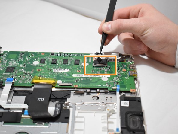

  7. Acer Chromebook CB5-132T-C8ZW Motherboard Replacement: crwdns2935265:07crwdnd2935265:01crwdnd2935265:02crwdne2935265:0 Acer Chromebook CB5-132T-C8ZW Motherboard Replacement: crwdns2935265:07crwdnd2935265:02crwdnd2935265:02crwdne2935265:0
    • Remove two 4.7mm JIS #1 screws from the black tab on the top right corner of the motherboard.
    • Flip the black tab up.

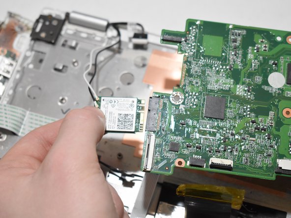

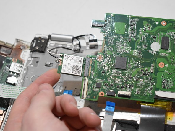

    • Lift the motherboard up from the laptop using a spudger tool.
    • Disconnect the chip attached to the right side of the motherboard.
