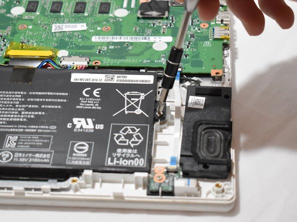

    • Remove two 4.6 mm JIS # screws at each end of the battery.
  4. Acer Chromebook CB5-132T-C8ZW Battery Replacement: crwdns2935265:04crwdnd2935265:01crwdnd2935265:03crwdne2935265:0 Acer Chromebook CB5-132T-C8ZW Battery Replacement: crwdns2935265:04crwdnd2935265:02crwdnd2935265:03crwdne2935265:0 Acer Chromebook CB5-132T-C8ZW Battery Replacement: crwdns2935265:04crwdnd2935265:03crwdnd2935265:03crwdne2935265:0
    • Carefully pull out the ribbon cable attached to the motherboard that runs wires to the battery.
    • Remove the battery.
